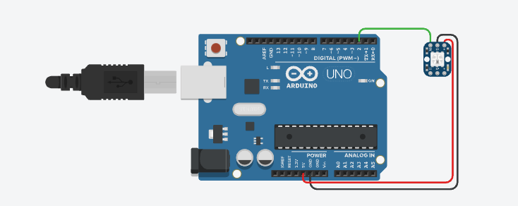

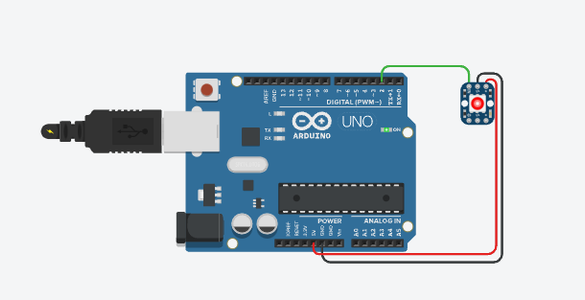

Step 1: Wiring
Let's start wiring. To begin, we need to first, wire the IN pin to any digital output pin on your Arduino, for this example, I've used pin 2. Now, you need to wire the G to ground, and + to the 5V pin. Once you have completed that, you may now move onto coding your Neopixel!
