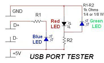

Step 2: USB 3.0 Power Meter
Adding USB 3.0 Power monitor is great function to test any USB power supply or USB device test.
Part List
> Arduino Network tester
> USB 3.0 Dual Female adapter
> MAX471 Current sensor Module
> Some cable and Glue..
Please check Youtube for more detail..
