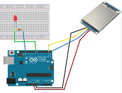

Step 2: The Circuit
  • Connect Nextion Display VCC red wire to Arduino 5V pin
  • Connect Nextion Display GND black wire to Arduino GND pin
  • Connect Nextion Display Yellow wire (RX) wire to Arduino TX pin
  • Connect Nextion Display Blue wire (TX) wire to Arduino RX pin
  • Connect LED positive pin to Arduino digital pin 6
  • Connect Resistor one end to LED negative pin
  • Connect Resistor other end to Arduino GND pin

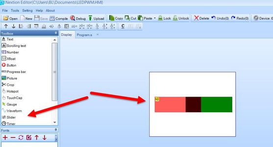

  • In the Editor on the left in the "Toolbox" find "Slider" & drag it to the right
  • Center & Resize the Slider
  • In the "Event" window > Touch Press Event" Check the "Send component ID"
  • In the "Event" window > Touch Release Event" Check the "Send component ID"
  • In the Toolbar click on the "Compile" button

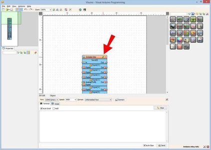

Step 4: Start Visuino, and Select the Arduino UNO Board Type
The Visuino: https://www.visuino.eu needs to be installed. Start Visuino as shown in the first picture Click on the "Tools" button on the Arduino component (Picture 1) in Visuino When the dialog appears, select "Arduino UNO" as shown on Picture 2

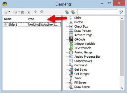

  • Double click on the "DisplayNextion1" And in the Elements window drag "Slider" to the left side.

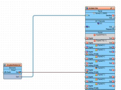

  • In the properties window: Make sure that the Max & Min are the same values as the maxval & minval in the Nextion Editor (see picture 3 & picture 4)
  • And close the Elements window
  • Connect "DisplayNextion1" pin out to Arduino Serial pin
  • Connect "DisplayNextion1" > "Slider1" pin Out to Arduino Analog PWM pin [6]

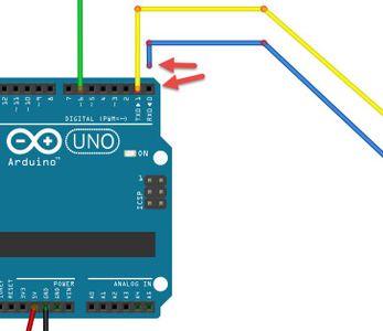

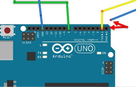

  • Before Uploading Disconnect RX pin on Arduino and After the Upload Connect the RX pin back (see picture 6)
