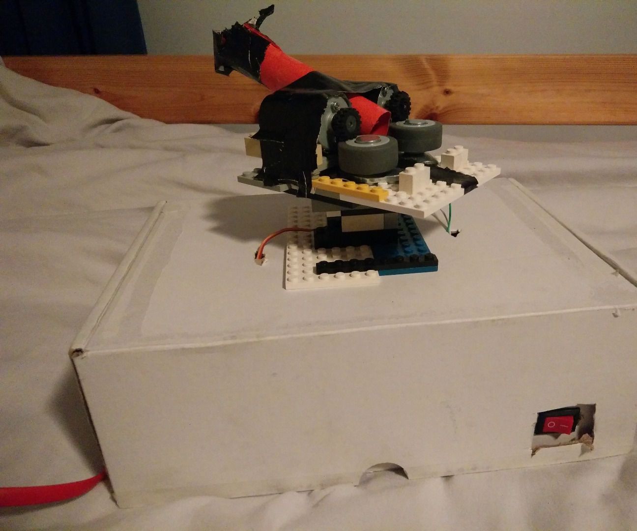

Step 1: The Build
In the schematic above you can see all the versions (buzzer, Processing, with LED) layed out. You will only need to look at certain parts of the schematics, which will be mentioned in the versions below.
Buzzer
If you want the buzzer to make noise when sound is detected, you will need to connect that part of the diagram. Optionally you can wire up the LED as well if you like, it is included in the code.
- Buzzer connected to Gnd and Pin 9.
- LED connected to Gnd and Pin 13 thru the 220 Ohm resistor.
We used the screw on our sensor to set the sensitivity.If the LED is permanently on, turn it counter clockwise first until it's off. Then turn clockwise until it's on again and back off slightly.
Sound file using Processing
For this version it is important that your Arduino is connected to your pc. This is how it sends the data to Processing. Build the diagram above apart from the buzzer. Again, you can connect the LED if you want to.
- Connecting your sound sensor will be different depending on the brand. For the VMA309 we connected + to 5V, G to Gnd and DO (Digital Out) to Pin 3.
