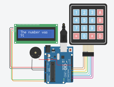

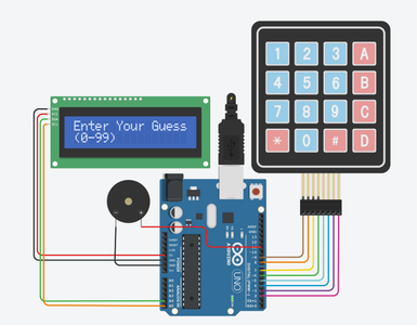

Step 1:
Circuit Diagram
  1. Connect the Keypad:
  2. The 4x4 keypad has 8 pins, which connect to the Arduino’s digital pins. (check the image)
  3. Connect the LCD:
  4. The I2C LCD connects to the Arduino’s SDA and SCL pins (typically A4 and A5).
  5. Connect the Buzzer (Optional):
  6. Connect the positive pin of the buzzer to a digital pin (e.g., pin 11) and the negative pin to the ground.
