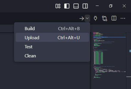

Upload the code using the dropdown in the top right.

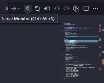

Upload the code and open the Serial Monitor using the dropdown in the top right.

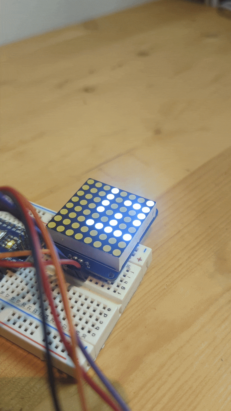

The rest of the code just prints out the generated maze to the serial monitor and prints a portion of the maze to the LED matrix, as well as the blinking character at the maze's start position. The character blinks at a configurable frequency to distinguish it from the maze's walls.

You'll notice the player is always in the same pixel and that we move the maze around it to give the illusion of movement; this is a common practice in video games. We also make sure the player can't go through walls by checking if the pixel the player is trying to move to is a wall. If it is, we don't move the player.
Lastly, the end position also blinks like the player, and when the player reaches the end, we play the win animation and generate a fresh maze.
