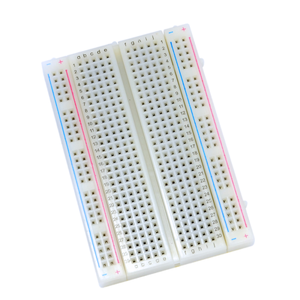

  3. OLED Display
  4. 1k ohm resistor
  5. LED
  6. Rotary encoder
  7. Jumper wires

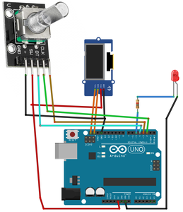

Step 2: The Circuit

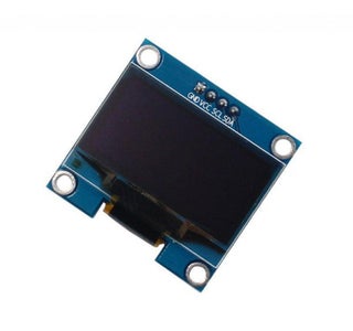

🔌 OLED Display Connections
  1. Connect OLED Display pin [SCL] to Arduino pin [SCL]
  2. Connect OLED Display pin [SDA] to Arduino pin [SDA]
  3. Connect OLED Display pin [VCC] to Arduino pin [5V]
  4. Connect OLED Display pin [GND] to Arduino pin [GND]

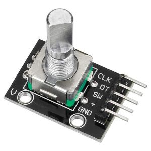

🔄 Rotary Encoder Module Connections
  1. Connect Encoder pin [CLK] to Arduino pin [3]
  2. Connect Encoder pin [DT] to Arduino pin [2]
  3. Connect Encoder pin [SW] to Arduino pin [4]
  4. Connect Encoder pin [+ (VCC)] to Arduino pin [5V]
  5. Connect Encoder pin [GND] to Arduino pin [GND]
🔴 LED Output Connection
  1. Connect 220Ω resistor to Arduino pin [5]
  2. Connect anode (long leg) of Red LED to the resistor
  3. Connect cathode (short leg) of LED to Arduino [GND]

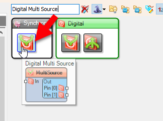

  4. Add 2X "Digital Multi Source" component

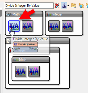

  11. Add "Divide Integer By Value" component

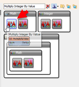

  12. Add "Multiply Integer By Value" component

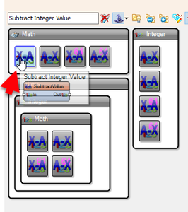

  13. Add "Subtract Integer Value" component

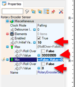

  6. Select "RotaryEncoderSensor1" and in the properties window select:"Initial Value" and set 10 and set "Max > Roll Over" to False and "Min > Roll Over" to False and Min Value to 0.

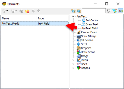

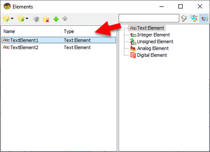

  11. Double click on "FormattedText1" and in the Elements window drag 2X "Text Element" to the left side and for both in the Properties window set "Fill Character" to 0 and "Length" to 2

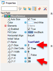

  12. Double click on "DisplayOLED1" and in the Elements window drag "Text Field" to the left side and in the properties window set "Size" to 2 "X" to 30 and "Y" to 20

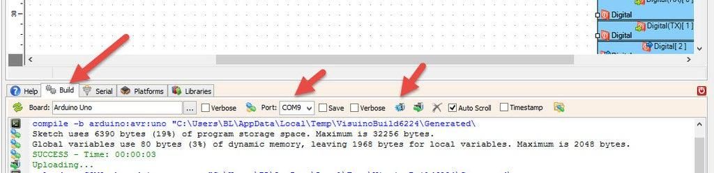

Step 7: Generate, Compile, and Upload the Arduino Code
In Visuino, at the bottom click on the "Build" Tab, make sure the correct port is selected, then click on the "Compile/Build and Upload" button.
