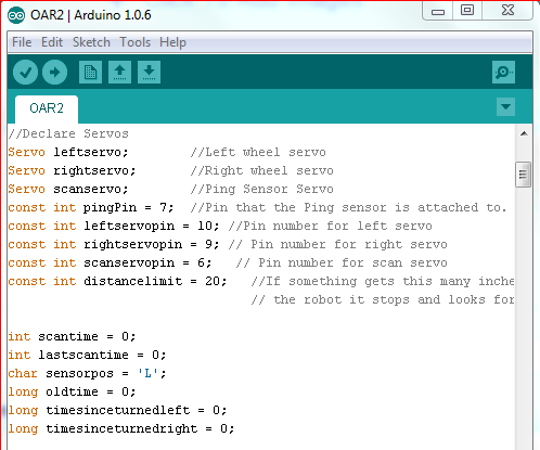

Yay! This is the final step! Now, connect the arduino to your computer and paste in this code into your Arduino program and install it into your Arduino (make sure you verify the code, just in case). I give credit for this code to Brandon Campbell. Check out his YouTube videos because he got some really awesome videos and tutorials (this Instructable was based on this code, and since he didn't give a tutorial I decided to give one myself).
Code: https://docs.google.com/document/d/1EULUhXL978xHmI...
After that, plug in the power pack into the smaller plug onto the Arduino, turn it on, and watch your robot go! If it does not go, feel free to ask me in the comment below, or through my email. I will try my best to reply as soon as possible and thanks for reading this Instructable! If you like this, please follow me for more fun projects like these and I will see you again!
