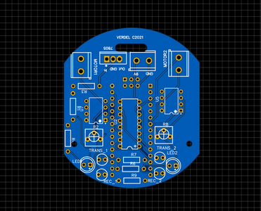

Step 3: PCB Design
The PCB is a 2 layer for obvious reasons there is just not enough room for all the components on one side, I decide to place the arduino nano in the bottom so that all the other components would fit on the top layer and it would be easier to assemble and wire.
The original circuit uses a 9V battery and 2 AA batteries, we can run our robot using only the 9V battery by dropping the voltage to 5V. Most of the components run on 5V, the motor drivers inside the L293D can handle up to 36V, so we will feed the 9v to run the DC motors.
the Op-amp will be used as a comparator, we need to add a variable resistor so we can adjust our reference voltage or our detecting distance.
