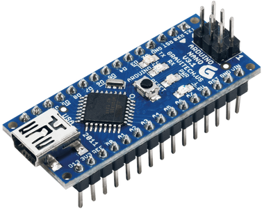

  1. Arduino Nano

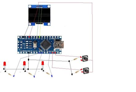

Step 1: Schematic Diagram
Make the connections of the components according to the diagram below
Step 2: Construction
we can build the assembly on test wiring or breadboard following the wiring diagram
