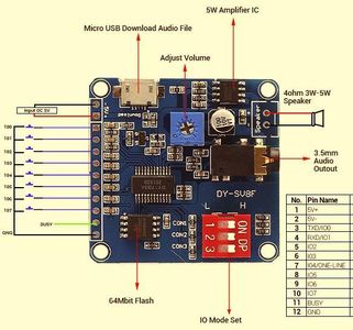

Step 15: Sound Playback Module
The PEMENOL Voice Playback Module stores mp3 files of the sounds. You connect the playback module to your computer and copy files to it just like a USB drive. The module includes a built-in 5-watt amplifier, so you can connect it directly to a speaker.
Triggering Sounds
The module operates in different modes, with each mode corresponding to a different method for triggering specific sound files to play. The red dip switches allow you to select the mode that the module will operate in.
I used the 'Direct IO' method. In this mode: The playback module has 8 inputs, with each corresponding to an individual sound file. The Arduino puts a low signal on the input that it wants the module to play. The module then plays the entire sound file once it is triggered (even if the Arduino stops producing the trigger signal). However, if the Arduino triggers a different sound to play, the Playback Module immediately switches to playing this new sound file.
Operational Notes
  • In my experience, I encountered an error each time the coffin system was first powered up, and the Playback Module played its first sound file.
  • During playing of its first sound file, the Playback Module would suddenly start playing static noise. This would last for about 30 seconds.
  • Once, I had to cycle the +5V power on the Playback Module to get this to stop.
  • After this static noise on the first playback, the Playback Module worked fine. This only happened when the coffin system had been unplugged, and was now powered up.
  • Once I switched to using an external amplifier (next step) this issue no longer occurred.

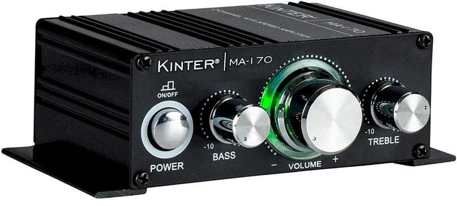

Step 16: Amplifier (optional)
Over Halloween, I felt the speaker should have been louder. I have since upgraded to a cheap 10+watt amplifier. The playback module has a line-level (unamplified) output. I connect this line-level output from the playback module to the amplifier using a headphones-type (3.5mm-plug-to-RCA-plugs) cord. The amplifier then connects directly to the speaker and drives it.

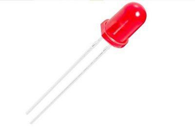

Step 20: Skeleton Eyes
To give the skeleton light-up eyes, wire two red LEDs together in series, along with a 70 to 100 ohm resistor. The current will have to go through all 3 components in series. This should be connected to a +5V output pin of the Arduino. The three components must be wired in series because the +5V from the Arduino will drive too much current through a single LED. It would burn it out.
Drill holes in the eyes of the skeleton. Cut out a small portion of the rear of the skull in order to mount the LEDs from inside the skull (LED poking thought the eye holes, leads and wires inside the skull). I used a small amount of glue to secure the LED in each eye.

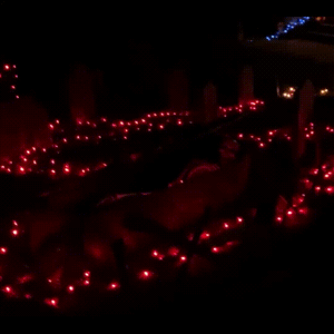

Step 24: Final Setup
  • Keeping kids back
  • I hammered broken wood pieces (from a pallet) into the ground to form a spooky fence around the coffin.
  • I didn't want little kids touching or getting hit by the coffin lid.
  • I would like to add a kill-switch on the outside of the coffin to deactivate the motor immediately. Just in case.
  • I used red Christmas lights in and around the coffin to illuminate the skeleton and surrounding graveyard. I may switch to a red flood light (for brighter light).
