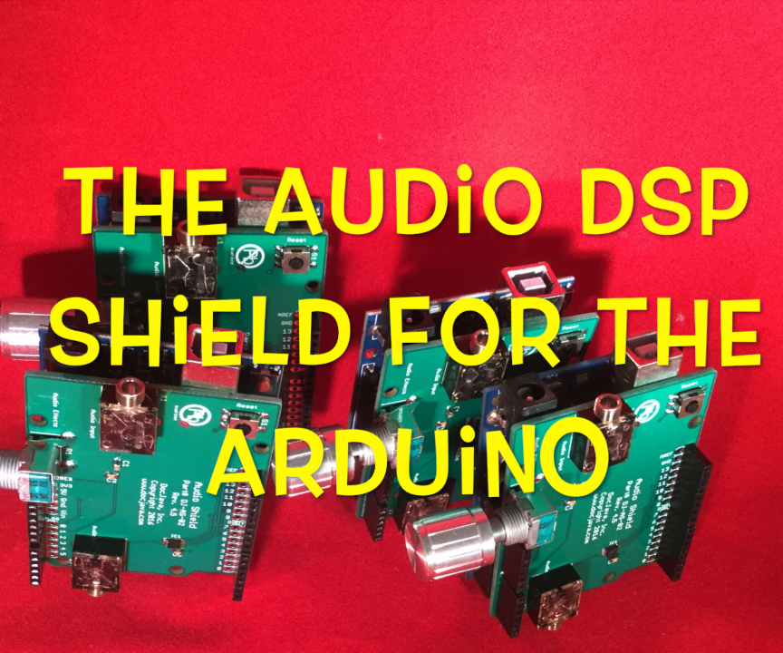

Introduction: Arduino Oscope
We present the details of getting the arduno oscope to work, using the shield available on kickstarter at: http://tinyurl.com/AudioShield
