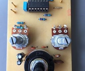

Step 1: Constructive Aspects - Part One
Let's go now turn to the constructive aspects of our project:
We will do two tests, one with the simulated environment by a dark tube (this environment will not allow interference from outside), and another test with the open environment, where we can interfere externally and thus, verify the system response.
Test - 1
The environment is simulated by a dark tube (black).
At one end of the tube, we will have a white LED with high-brightness (it will be used to illuminate the environment). At the other end of the tube, we will have a LDR (the LDR will be used to manage the amount of light in the environment, it will be our system's feed back).
The connection with the Arduino is very simple:
The pin D3 (digital 3) of the Arduino will be used as output and is connected to the LED's anode. The LED has a resistor of 220 Ohms in series with the anode (for the LED's polarization); the LED's cathode is directly connected to GND.
The pin A0 (analog 0) of the Arduino will be connected to the LDR and used as analog input. The LDR has one leg connected directly to the +5 V supply, and the another leg of the LDR is connected to a pull-down resistor value of 10K (the resistor will be connected in series with the LDR and connected to the GND. At the intersection of the LDR + resistor we will have the output signal of the light sensor that will be connected to the Arduino's pin A0.
Look at the pictures to know how to do the circuit interconnection of sensors and actuators with Arduino, the circuit was designed with Fritzing.
Test - 1
