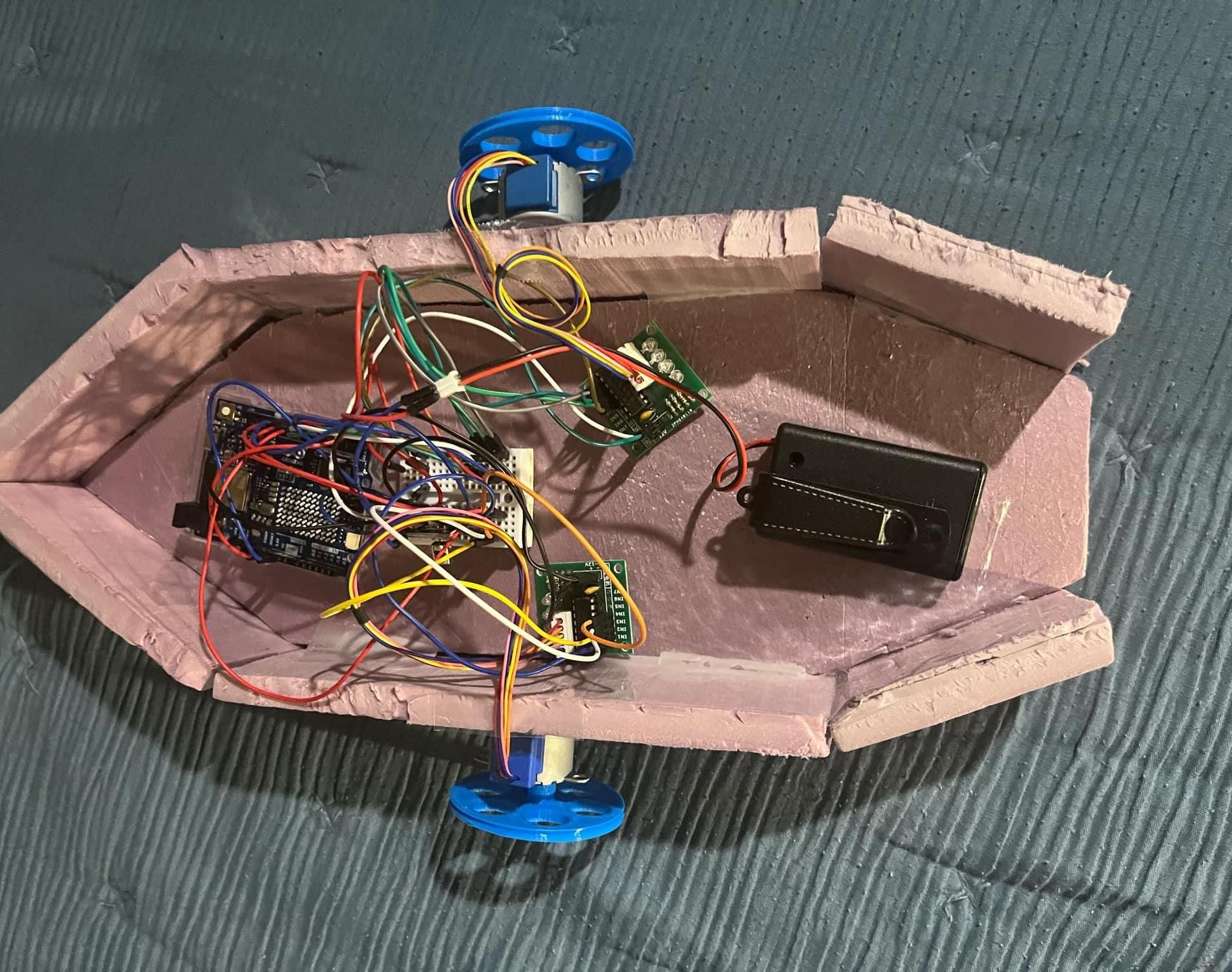

Step 3: Wire Arudino to Motors & Power Supply
After uploading your code, the next step involves wiring and setting up the hardware components. In the diagram above, the transistor icon represents your motor for this project.
- Connect a snap connector to the first 9V battery and plug it into the Arduino.
- Connect another snap connector to the second 9V battery and plug it into the DC power connector.
- Wire your motor to the DC power connector, and also connect it to pin 8 and pin 9 of the Arduino, as shown in the diagram.
I have also uploaded a short video demonstrating how the web server controls two motors, which you can use as a reference (if you want to know how to connect 2 paddles into 2 motors, please refers to step 4)
Step 4: Set Up the Motor Placement/boat Placement
First, remove the motor horn and hold it as shown in Picture 1, with the circular part facing downward.
Then, gently insert the horn into the center of the paddle, keeping the circular part facing down as in Picture 2.
Next, take up the motor, flipped it 180 degrees and put your finger underneath to hold the horn. By using your finger underneath to support the horn and paddle, you can keeping them in place as you attach them to the motor shaft.
Once assembled, mount both motors with their paddles into the boat. Secure the motors and horns with nails.
Finally, to ensure the motors stay in place, consider applying a layer of glue or tape to hold them firmly on the boat body.
