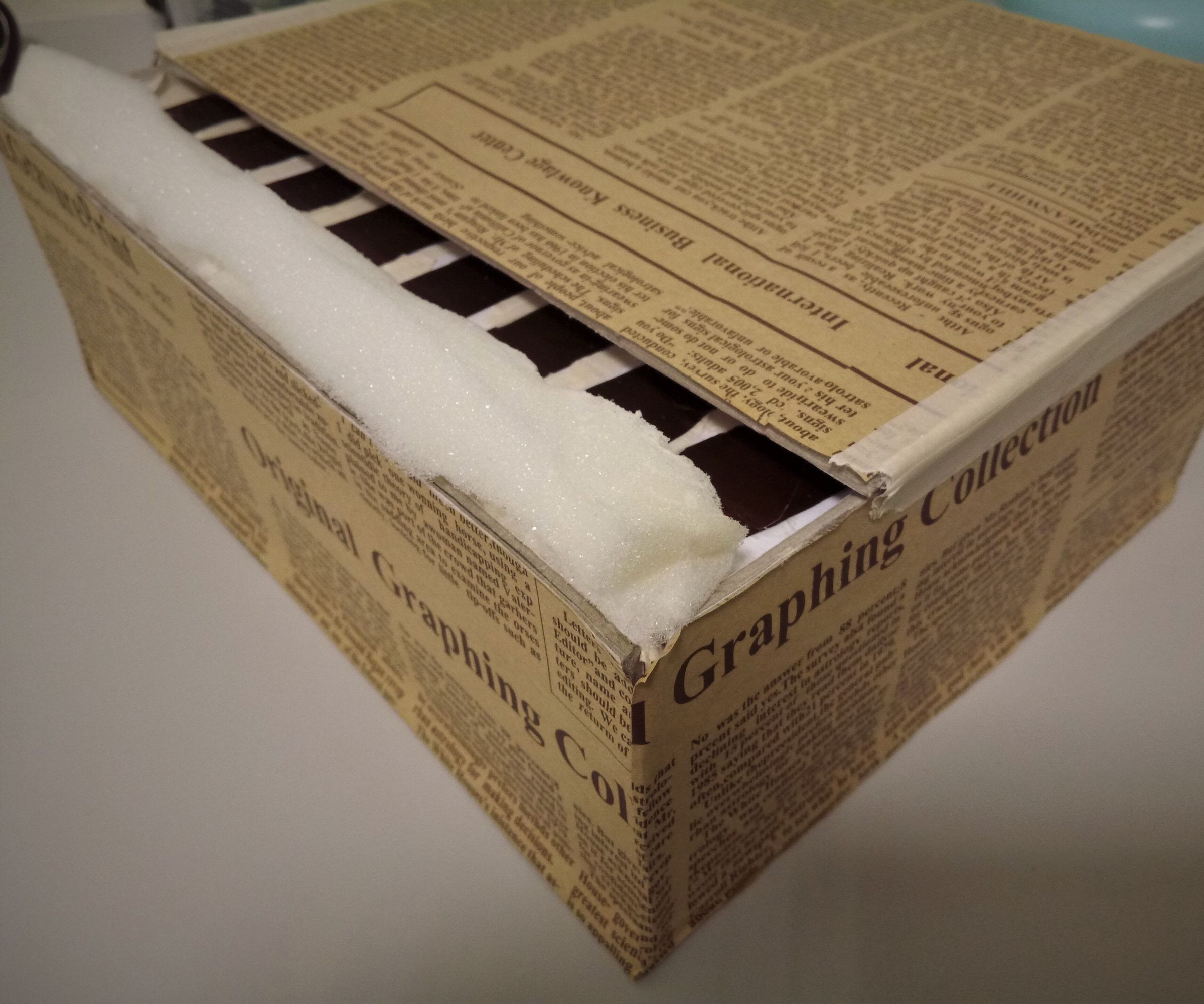

Introduction: Arduino Paper Piano
I made it and improve this project based on paper piano with arduino-- Hackster.io
You could also find this original idea in paper piano with arduino-- Arduino Project Hub
The changes I've done to the paper piano above is not only the appearance but also the way that the wires are connected to the breadboard. Using the previous way cause few problems: the wires are too close to each other and they're sensitive, so the sounds won't stop unless you could separate the wires from not touching each other, but this could be tough because how the wires are designed to be put closely. Also, there are few mistakes in the schematic. That's the main reason why I changed these places.
