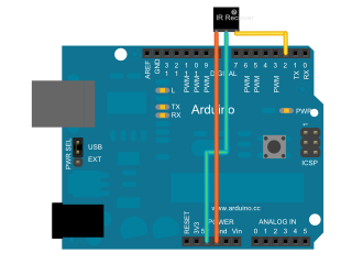

Step 3: Remote Controller
Since everything is controlled by arduino this was easy task. There is arduino library IRremote and lot of great tutorials on how to use them like this one https://learn.adafruit.com/using-an-infrared-library/hardware-needed.
For controller itself I reused old one. On link above You can learn how to read signal of old remote and re purpose it.
You can find code with explanations further down.

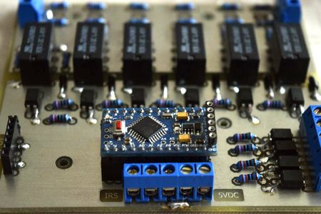

Step 5: PCB Layout
And now to put all that together. I used eagle cad for drawing schematic and pcb. You can find image and eagle project.
I decided to separate signal ground from "digital" that is why I have 2 polygons on top layer. I put mass as polygon and marks on top, and everything else is on bottom layer.
You can check attached fritzing breadboard scheme notes if you need more explanation how to connect peripheries to arduino.

First import IRremote library and initialise it:
#include //import library before including from here
byte RECV_PIN = 11;
IRrecv irrecv(RECV_PIN); //initialization
decode_results results;
Inside setup()
irrecv.enableIRIn(); //enable ir in

I tested it and it works good. Not all steps are equal in attenuation but it is good enough, there are enough attenuation steps to find sweet spot. Only problem is that sometimes there is some noise for millisecond when relay switches on. Maybe I need better relays or something else (any ideas? :)).
For next version I will include relays for channel selection on pcb, but for that job I will need to shrink project since size of my board is on limit for freeware. I even have the idea to redraw all other boards (amp, buffer, PSUs, riaa...) I have now in my hifi on single one to remove all cables inside, but that will be in next instructable.
