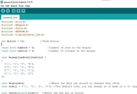

Uploading the code
This completes the circuit connection and now we can upload the code to the board, Just copy and paste the below arduino program to your IDE and click on the upload button.

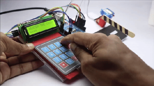

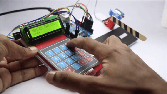

Press the '*' Key,Now the LCD clears the current display and shows the message "ENTER THE CODE" and code waits for the user to enter the password, Type the default password 1234 and now the gate opens
Changing the password
To change the password press the # button and now will have a console to change password on the LCD, First enter the old password and later you will be shown panel to enter and confirm new password.
If the entered password is correct (matches the stored password), the servo motor rotates to open the door and LCD displays "Access Granted" and "WELCOME!!". In the other case If the entered password is incorrect the LCD displays "CODE INCORRECT" and "Invalid!!!".

Using this is very easy all you have to do is power on the project using USB power source, Now you will see the display message asking to enter the password.
Press the * button and now you can see in LCD asking to enter the code, enter the default password 1234 and then press A
The servo lifts the gate and after some time it closes you can adjust this time on the code as per your needs.
Now if you are entering the wrong code the gates will not open and the LCD will show error message "Incorrect Password"
