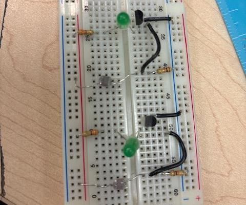

Step 1: Connect LEDs to Breadboard & Arduino
The first step is to connect the LEDs to the breadboard properly and to connect them to the Arduino Uno Board aswell. You first connect the Red LED to ground using a black jumper wire. You then connect the positive end of the LED to the Arduino where I used pin 10. Next you need to connect the yellow LED to ground using another black jumper wire and then connecting the positve end of the LED to the arduino where I used pin 9 but you can use any pin you would like. Next would be the green led which is pretty much the same set up which is connecting the LED to ground using another jumper wire and connecting the LED to the Arduino board using another wire but to pin 8.
Step 2: Connecting Button
The next step for this project is to connect the button to the breadboard and the arduino. You must connect the button to the power rail using a 330 ohms resistor. I also connected the button to ground using a jumper wire. Then you must connect the button to the arduino board using another wire and you connect it to the third pin on the arduino.
Step 3: Connecting Buzzer/Speaker
The next and final step on the Breadboard is connecting the buzzer. In order to do this step, you need to have a jumper wire and connect it to ground and you need to also take another wire and connect it to the arduino. I connected this wire to the arduino board pin 2 but you can use any pin on the arduino board.
