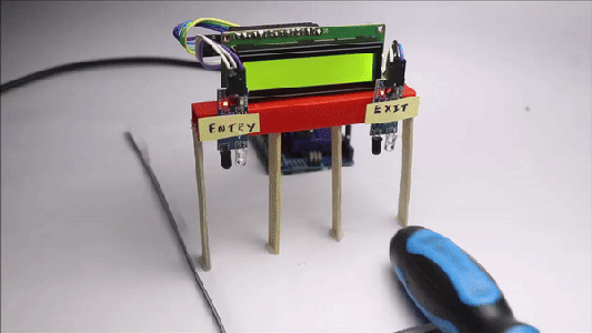

D2 and D3 pin of Uno hold the signal pins of the IR sensor, Gnd and Vcc pins from the IR module is connected to the Gnd and 5v pin of the Uno.
The LCD module has I2c so we have reduced a large number of pins to only 4 Scl, Sda, Vcc and Gnd.
Sda to A4, Scl to A5 is connected with these default connections the LCD module works well without any issues.
After these connections are complete, Open Arduino IDE on your computer and paste the below code.
Here the catch is if you have never used LCD in your Arduino projects you might need to install the LCD library.
Select the proper type of port and board type and click on the upload button, wait for some time and now the board is ready and we can do some testing here.
Step 2: Testing the Circuit
Connect the jumper wires to I2c module, IR sensor module can be adjusted later as per the requirement.
You may think by default the Uno board has only one 5v pin, But we have 3 module that needs this pin.
Peel of the cable from these 3 module and converge to only one jumper wire and connect this to Uno board, this not only shrinks the wire used but also make the project look neat.
Now once these connections are completed you can test the circuit by powering on the project by USB cable.
Place the hand infront of the IR sensor and if everything is correct the LCD panel should show some counts.

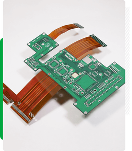

Check Here for Rigid-flex Pcbs with this your circuit becomes flexible! I have added the images to this step kindly check.
A revolutionary solution that combines the best of both rigid and flexible circuitry to elevate your electronic projects to new heights.
With their expertise in advanced manufacturing techniques, they offer a seamless integration of rigid and flexible components, ensuring enhanced reliability, durability, and space-saving benefits.

I will use simple materials to make the doorway for this project, The popsicle sticks serve best role here.
Make U shaped door and using hot glue paste this on the piece of cardboard, i had a square kind of long thing which served
Step 4: Finishing
To my project idea i will be using entry and exit message boards, This will be added to the top of the door.
You can also add the LCD panel on the sideways anyways it depends on the setup you will be following, i chose to make this as a roadway in which the person can walk into and out of the door.
To use this project all you have to do is connect the arduino uno board to the usb power supply.
Wait for the LCD panel to show message, Now you can place any object in front of the sensor and the sensor led blinks and now the count of entry/exit will be shown in the LCD panel.
Customize the message on LCD screen as per your requirements and have fun with this project.
