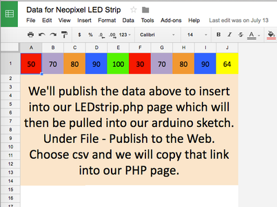

Step 1: Setting Up a Google Sheet
You first can set up a Google Sheet with numbers across the top row which will represent the percent of proficient students. In my simple example here I just used 10 data points in the various color ranges.
Next under File, you "Publish to the web". Choose "Entire Document" and "Comma-separated values (.csv)" and Publish. You need to copy that .csv link because we will be inserting it into our PHP page.
When we are done with this entire project, if you go into this Google Sheet and change one of the data points then (after a few minutes) that particular LED will update it's color. Below is a link to this sample Google Sheet if you would like to make your own copy.

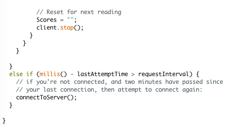

This code resets for the next reading and starts the loop over.
