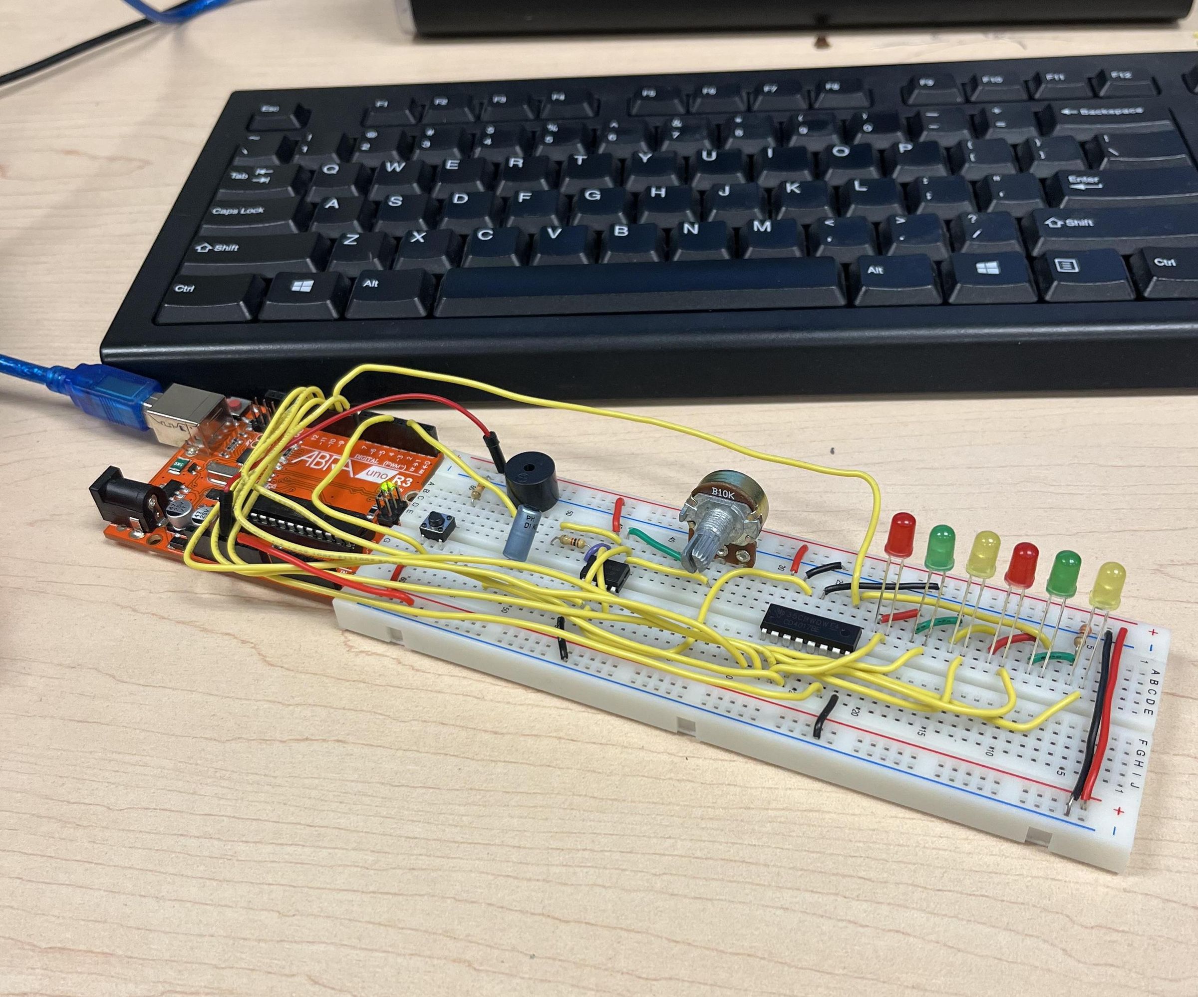

Step 2: Getting the Push Buttons Wired Up
The push buttons need to be wired to the D4-D9 Pins of your Arduino. The other end needs to be connected to the negative rail of the breadboard. This picture should help
Step 3: Plugging the Buzzer and GND In.
Plug the Arduino's GND into your breadboards negative rail.
Plug the Buzzer's Negative into the negative breadboard rail and the positive into the D11 PIN on the Arduino
