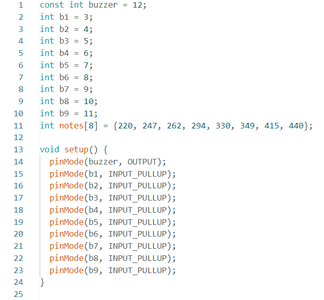

  1. Initialize the pins for the buzzer, buttons, and switch, ensuring that they correspond to the correct ones on your Arduino.
  2. Create an array of eight notes which will serve as your scale; I used A Major as my default scale. - each element in the array is an integer value that represents the frequency of each note in Hz (see this website for conversions)
  3. In the setup function, initialize your buzzer pin as an OUTPUT and all other pins as INPUT_PULLUP (do not simply use INPUT since our buttons are wired without pull-up resistors)

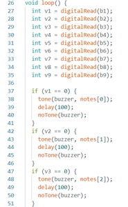

  4. In the loop function, initialize the variables representing the button and switch states by declaring them as integers.

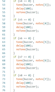

  5. Use if conditions to check the state of the buttons. If they are equal to 0 (the button is held down), then use the tone(), delay(), and noTone() functions to play a certain note for 100 milliseconds. Ensure you are indexing the notes array starting from 0.

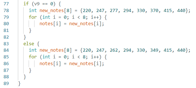

  6. Finally, check the state of the switch. If the switch pin reads 0, initialize an array with the frequencies of a different scale, then use a for loop to set the values of the main notes array to those of the new scale. If it reads 1, then carry out the same procedure, except resetting the notes to those in your default notes array on line 11.
