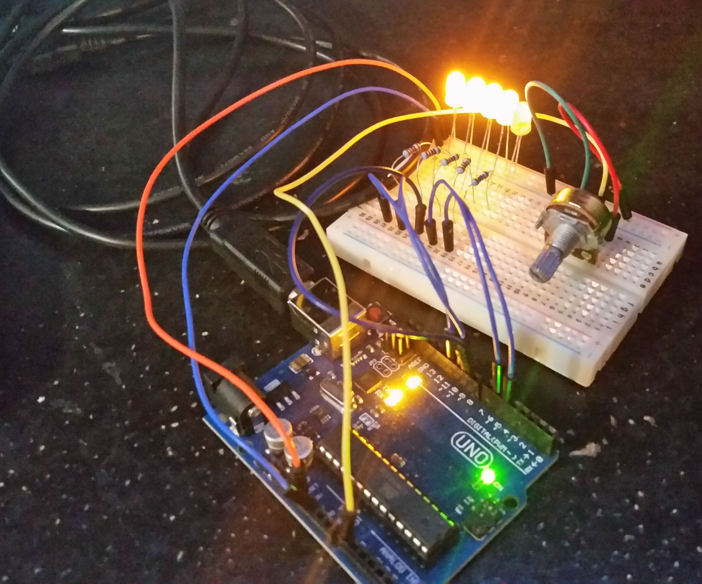

Introduction: Arduino Piano in C#
In this project, we will make a music keyboard controllable from any Windows computer from an application written in the C# programming language. The breadboard setup is very minimal. Where we will concentrate our efforts is in the code, which will allow notes to be played at the press of a button and songs to be played when a hotkey is pressed.
One added bonus I included is to create a simple light show to play along with our music notes for added effect.

Step 1: Connect the Buzzer
Parts needed:
1 Piezo buzzer
1 220 Ohm resistor
We will first create a simple connection to a Piezo buzzer, included in many basic Arduino starter kits. This will serve as our "speaker" for the keyboard we are building. A buzzer is not as loud as a speaker might be, but for this project, it will do fine.The 220 ohm resistor protects the buzzer from being overloaded with current. You can use a lower ohm resistor to make the buzzer louder.
Simply connect the buzzer to one side of the breadboard. Bridge a resistor across to the other side and connect it to pin 3 on the Arduino.
Next, connect the ground to the Arduino.
That's it for this step!
Step 2: (optional) Connect an LED
Parts needed:
1 LED (any color)
1 220 Ohm resistor
For a super-low-budget light show, connect an LED! You could really take this step to another level, but I decided to hook up a simple LED that flashes as the notes in our songs are played.
First, hook up the LED on the breadboard, bridging the resistor from the long probe on the LED to the other side of the breadboard, like in the step where we connected the buzzer. Connect the resistor to pin 2 on the Arduino.
Then, connect the short side of the LED to ground, and we now have a spectacular light show to go along with our sound system.
Now we're ready to start coding!
