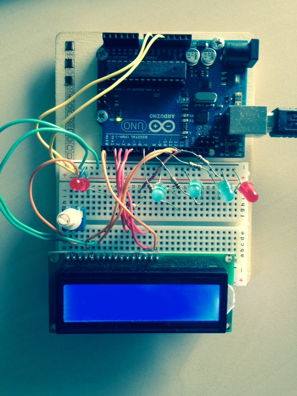

This is an Arduino Colleague Proximity notifier.
Function:
It pings IP-addresses for which the response is displayed with LEDs. If a reply is received, a corresponding LED switches on. It can also ping mobile wifi connected devices, or any other object with ip (such as a server) to check for status.

Step 2: Wiring
Wiring as shown on the photo. If in demand, I'll make a schematic for the setup.

Step 6: Getting It to Work
Upload the Arduino Code to the Arduino itself. Put the Python code into a .py file. If all goes according to plan, if you run the .py file, there's a small delay in response.
If it doesn't work: Check the port in the python file. Your Arduino may be labeled differently or be numbered differently. Check that the RSS feed doesn't have a ~ in the data. That will throw things out of whack. Try running the .py file from the command line as an administrator. Sometimes the script doesn't have proper permissions to access the COM ports
