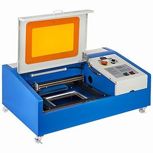

So I bought the K40 Laser having read all the horror stories about the controller and the wiring and the lack of power control and setting the house on fire and so on. I also downloaded Lightburn to give it a go as I had heard good things and spent a couple of weeks creating stuff in lightburn, saving as on SVG, loading into K40 Whisperer and engraving, quite successfully.

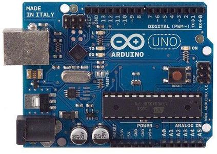

Arduino Uno
CNC Shield (V3.0 used for my application)

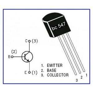

BC547B Transistor or similar.

The base or gate of the transistor needs to be connected via a 1 Kohm resistor to Z+ pin on the CNC shield.

The Laser momentarily arms when the Arduino is plugged in, for this to not be an issue, I make sure the door on my laser is open before plugging in the USB lead to the computer, noting I have a door interlock on my machine.
I have an ammeter, a voltmeter and potentiometer connected to my machine to limit the power from the laser so that the current is less than 14mA. The setting on the voltmeter is about 2.1V. This means that if I tell Lightburn that I want to cut at 100% power, the ammeter will read 14mA. If you go higher than this, you WILL shorten the life of your tube.
