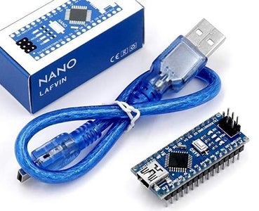

1 Arduino Nano (5 volt). I did not use a genuine Arduino but rather used an alternative with ATmega328P.
1 usb cable that fits the Ard.

Note that you are using the 5V from the Arduino to power these lights. Ensure the one you use is a 5V model and not a 3.3V. The Nano is a great choice as it is small and this is a fairly simple operation.
Note that I did not use any resistors here. I don't know if it is absolutely necessary but I did play around with it separately and yes, you can install a resistor to reduce the brightness. For this particular instructable I will leave it without a resistor and see what happens.
I should also note here that I was not initially able to get this Nano board compatible with my laptop and the Arduino IDE interface. This would not show up in my list of ports and so after doing some searching I had finally found some instructions on how to get this device to work. Apparently these alternative boards have some different drivers that required me to go out and find new drivers to make them work. If you clicked on your device manager you would see that there should be an ! next to the USB device and that required updating. Google search the CH340 drivers for the Nano and you will find separate instructions on that. I should note that it is not necessary to install the executable that was included in the download. You can just extract the files to act the files to a folder on your hard drive, and from device manager you can update the driver and have it search in that extracted folder.
