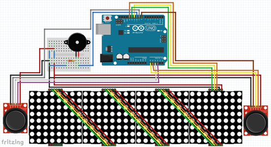

Drawing a schematic is an easy process which involves finding the components you need in the components library, placing them on the page and then making the correct connections. This process is greatly simplified if you have a schematic to work from before drawing it out on the computer. I will be using the wiring diagram from my previous Instructable shown above.
As you can see in the second image you use the green wires to connect the components placed from the parts menu together. I have also added headers for the Arduino connections, Power and Ground so I have connections for future upgrades. Soldering headers onto these connections is optional.

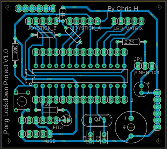

Once you have completed the Schematic you need to convert this into a board design. To do this click on the 'Switch to PCB' button in the top left in Fusion 360 or in eagle click 'SCH BRD' button next to save and print on the top bar. You will be asked whether you want to create a new document click yes.
You will be presented with a board and a jumble of components with lines between them. Try and arrange these components so the lines are as short as possible and, if possible the wires aren't crossing. You can then use the 'Connect' tool to draw on all the wires. If you do need to cross wires you can switch between the top and bottom layer of the board by using the drop down where it says '1 Top' then click '16 Bottom' to draw the PCB traces on the bottom of the board. You can switch back in the same way. To connect traces between layers you can use vias.
Above you can see what the PCB looks like after arranging all the components, I managed to fit all my traces on the bottom layer.
