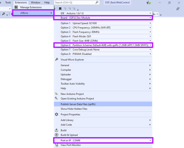

First select your Board and COM port, and check you have set the correct Flash Size for your board.

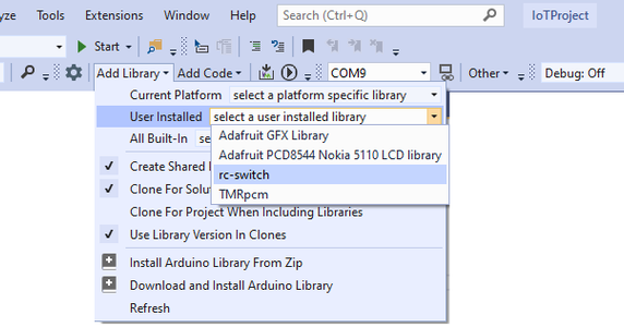

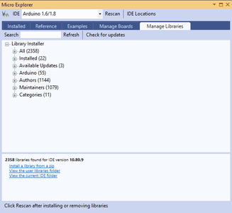

We need to install the Library, which can be done from the Library Manager in the Visual Micro Explorer:
  1. Open the Library manger from Visual Micro > Add Library > Download & Install Arduino Library
  2. Enter the library "rc-switch"
  3. Select the library and install by pressing OK
  4. Then click the Rescan Button
  5. Now close the Visual Micro Explorer

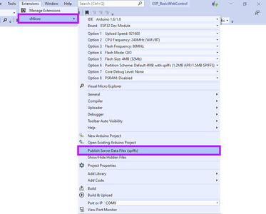

Step 5: Upload SPIFFS Files
Now we are ready to upload our files to the filesystem on the ESP chip.
Ensure the USB Lead is connected and the correct COM port is set in Visual Micro
Click Visual Micro > Publish Server Data Files (SPIFFS) to upload the files in the "data\" folder to the ESP Chip

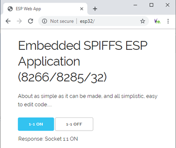

Load a web browser on your PC and navigate to http://esp32/, the page above should appear in the browser.
The page request from the browser causes the ESP32 to load the relevant file from the SPIFFS filesystem, and send it back to the browser.
When you press the ON / OFF buttons:
  • Browser sends the HTTP Request from the page to the ESP32
  • ESP32 will process this and transmit the RF message to the socket
  • ESP32 then replies back to HTTP request with the Response similar to above.
