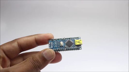

Arduino Nano got it from amazon

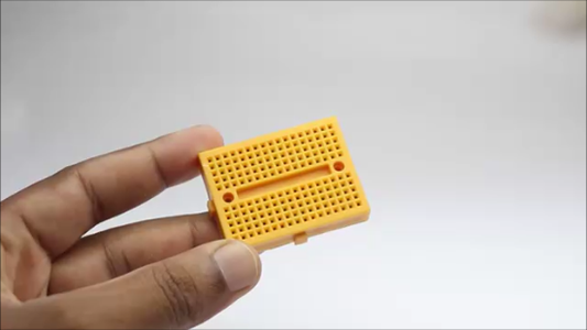

Small Breadboard

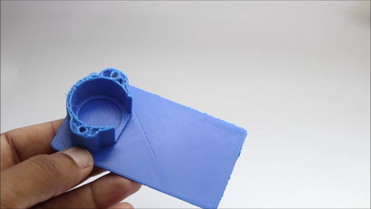

Step 1: Design and Printing

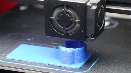

I made the design using Tinkercad application and I have given the files for you to use for free, Also you can customize the model as per your needs.
Stls are available below for your use, Download it and open the files in any slicer, i used cura and also i have given the settings that i used to slice the model.
There is no need to give rafts or supports and this is an advantage for us since it eliminates the need to post process the model after printing.
Turn on your printer, Feed the color of PLA filament of your choice and start the 3d printer.
It will not take much time to print the parts, After the print is complete save it for later use.
Here i have not given STL for OLED board 3d printed thing and knob for rotary encoder, you can find many files for this online feel free to use the best designs suitable for your use.

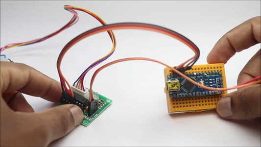

Step 2: Circuit and Codes
The circuit is straightforward for this project, I have made the circuit diagram very simple but i can make it even simpler for you guys by explaining component wise

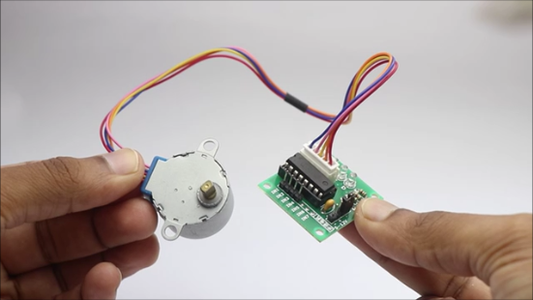

The stepper motor connections are as follows
IN1 to D8
IN2 to D9
IN3 to D10
IN4 to D11
VCC to 5V and GND to GND

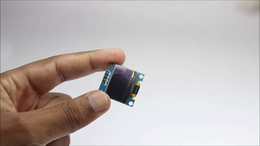

OLED board connections
Vcc and gnd to 5v and Gnd on the nano board
SCK to A5 and SDA to A4 pin on the nano

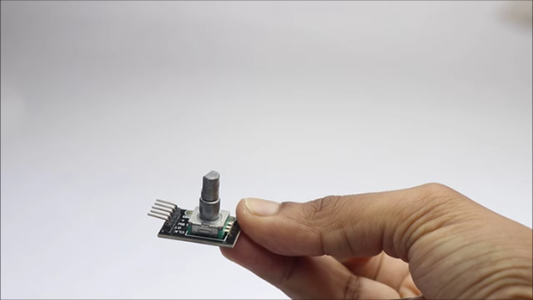

Rotary Encoder Connections
CLK to D2
DT to D3
SW to D4
+ to 5V and GND to GND
After these connections are complete, Copy and paste the below arduino program to your IDE
Connect nano board to computer, Select proper board type, type of board and click on upload

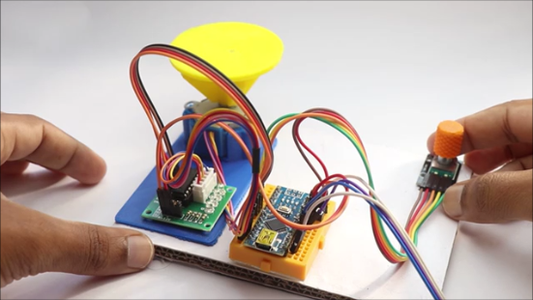

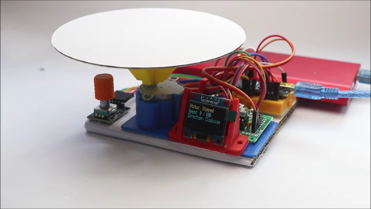

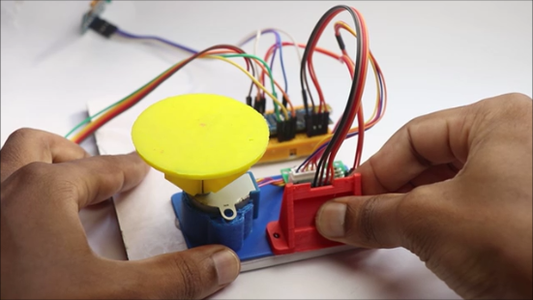

This is my favorite part, All you have to do is assemble the electronic to the 3d printed parts and i will now tell how to do that.

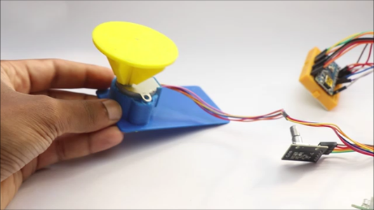

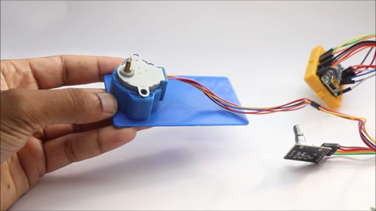

I will start by connecting the stepper to the base of 3d printed enclosure, This will hold the motor and its driver.
The press fit type of enclosure eliminates the use of additional glue/adhesive, Just place and gently press the components and you are good to go.
Now place the other electronics on the board and use hot glue/double sided adhesive to keep them intact.

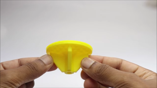

Place the knob on the shaft of stepper and this also does not need any glue to fit, i also made a 3d printed part to hold the OLED board, since it was not my work i didn't share the model.
Check online for free STLs for this part, Glue to the base and fix the OLED board, There are plenty of designs for the knob part of potentiometer.
Since the space was limited on the board, make sure all the components are placed well and all the wires are intact.
This completes almost all the assembly part except for the table part and we will now see in the next step on how that can be made.

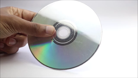

Step 4: Display Stand
To make the display stand there are many other ways but first let me tell you the method that i followed and i will say why i did so.

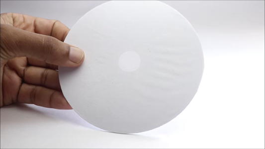

I made use of a cd that was not in use, I marked the dimensions of CD on a piece of paper, Cut the marked areas and pasted it on the CD.
My choice of color was white, Use the type of colors that you need, You can use different color background. I recommend using standard colors like white to the background.
Place this display stand on the center of stepper motor hub and now the stand is ready for using.

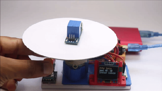

Step 5: Testing and Using

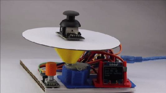

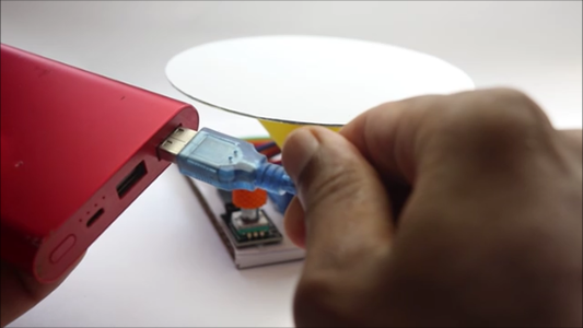

Using this is very easy, Just connect the nano board to USB supply and check for the status on the OLED board.

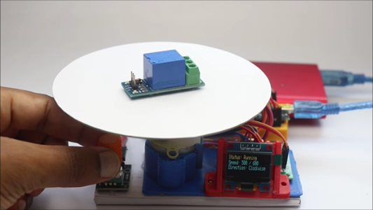

Place the object on the stand and press on the rotary encoder center button, When you do this the status on the OLED will show from stopped to running.
Turn on the knob according to the speed of rotation you require and proceed to record the video for your project.
Oh wait! There is an option to turn the table in anticlockwise direction also, The use of stepper motor ensures that the movement are precise and you can expect best quality videos along with smooth and vibration free movements.
If you shoot video and photo of small electronics components then this project is for you.
You can customise the background colors as you need depending on the type of project, You can always check for the status, number of rotation and clockwise or anticlockwise type of rotation on the OLED message board.
