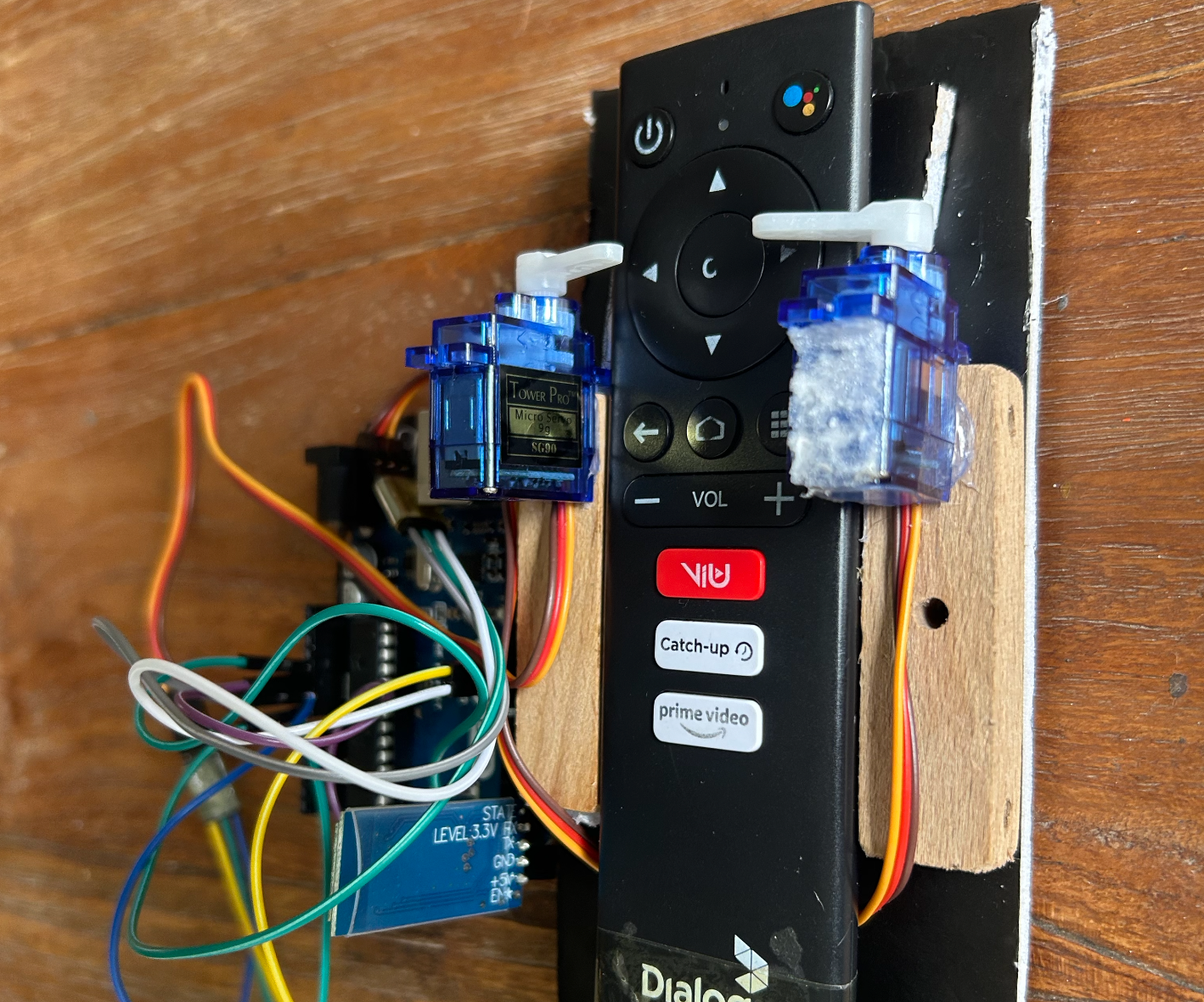

Step 1:
Connect the jumper wires to the following wires of the servo motor:
White => Orange/Yellow
Green => Red
Gray => Black
The colour of the wires on the left hand-side are my jumper wires and the colour of the wires in the right hand-side is the wires of the servo motor
Step 2:
Then connect the jumper wires to the following places on the arduino uno board:
White => pin 9
Red => 5v
Grey => Gnd Pin
Step 3:
Connect the 18650 Battery Holder to the following areas in the arduino uno:
negative terminal of the 18650 battery holder to the Gnd pin
positive terminal of the 18650 battery holder to the Vin pin

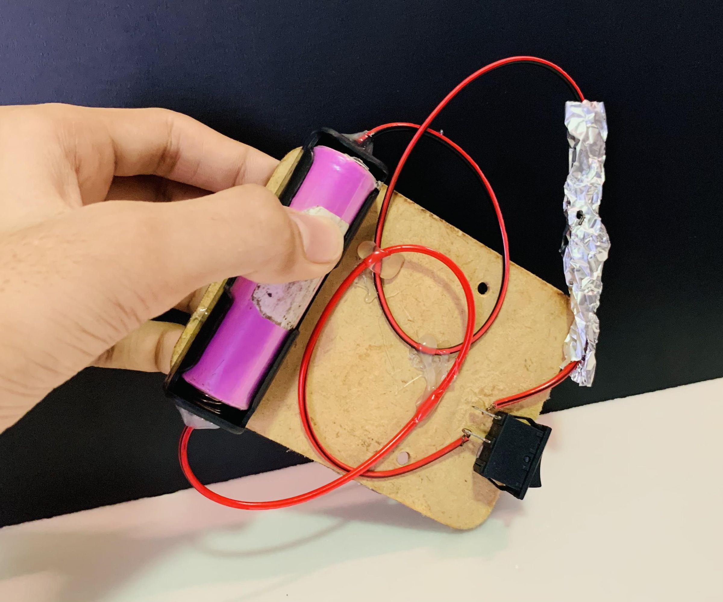

Step 7:
Put some Cello tape on the end of the jumper wires(which is the black plastic piece) to secure them
Step 8:

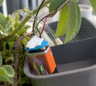

Connect the wires of the water pump to the 9v battery clip
Red represents the positive terminal
Black represents the negative terminal
Red => Red
Black => Black
Step 9:
Cut a small piece of the double side tape and stick it on the battery clip. Then paste a servo horn on the double side tape. Then pour some gun glue on the servo horn to make it secure
*Note: Make sure to wait 2 mins for the gun glue to dry
Step 10:
I have made a small setup that you can make (It has to make the servo touch to correct side of the battery connecter to make the water pump to turn on)
Step 11:
Lastly the water pump has to be in place to take in the water and send out the water like the photo above
