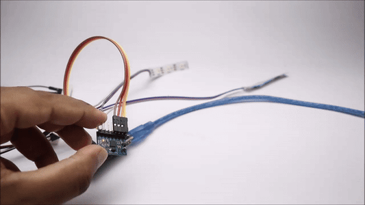

The circuit here is very straightforward, we have 2 parts here
One is the WS2812B strip and the other is the MPU 6050 sensor also called as gyro sensor
To indicate the directions i will use 2 led strip with 4 led on each strip, These are the connections
ARGB LED Strip: connections
Both the +5V from the strip is connected to the 5V power supply on the board
GND from both the strip is connect to GND on the Arduino nano
Data In or Din from one strip is connected to a digital pin 6 on the Arduino and the other Din to D7 of Nano
Gyro Sensor or MPU6050 connections
VCC and Gnd is Connect to 5V on the Arduino and Gnd
SCL pin is connect to A5 on the Arduino and SDA is connected to A4 on the Arduino

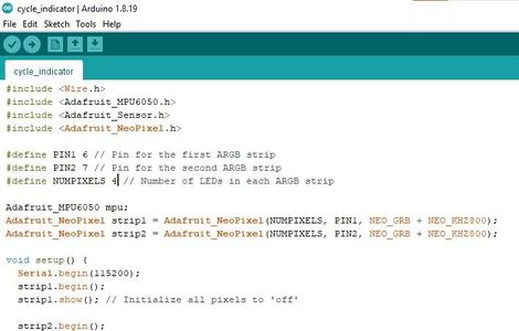

After these connections are complete you can head over to uploading the codes, and this is very simple
Copy and paste the program on your IDE, Here you need 2 library one is the gyro library and the other is neopixel
Install this and upload the code and now the circuit is ready for testing, You can change the colors and timing on the code as per your needs
Step 2: Test Circuit
Now after the program is in the nano and when you power it up with USB this is what happens, i will give you an overview of the technicals that run behind this.
MPU6050 accelerometer and gyroscope sensor are used to detect the orientation. The sensor reads the tilt of the device on the x-axis. When the device is tilted to the left, the first four LEDs on both ARGB LED strips light up indicating a left turn. Likewise, when the device is tilted to the right, the last four LEDs on both strips light up in , indicating a right tilt.
Here the Arduino processes the data from the MPU6050 and controls the LED strip lights accordingly, and we are using this as an indicator.

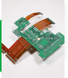

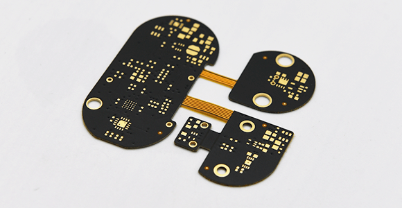

You also can simplify this circuit with a Simple small PCBComplete your electronic projects in the best way from PCBWay
They are raining great offers since their 10th anniversary is live enter now
Why them? They have provided me with the best PCB and The quality is just amazing compared to other providers in the market, They also have Color PCB printing Try it out.
Don't have a 3d printer? You can get the best 3d printing service here

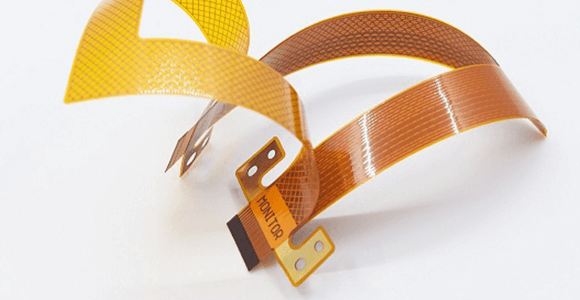

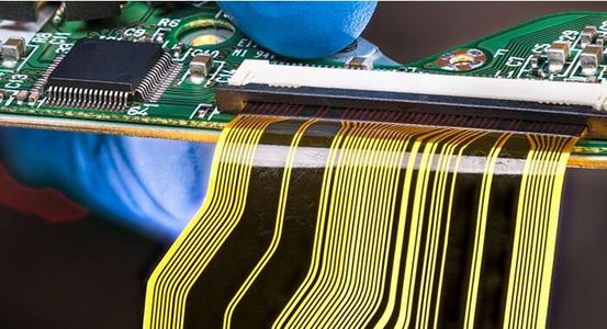

Check Here for Rigid-flex Pcbs with this your circuit becomes flexible! I have added the images to this step kindly check.
A revolutionary solution that combines the best of both rigid and flexible circuitry to elevate your electronic projects to new heights.
With their expertise in advanced manufacturing techniques, they offer a seamless integration of rigid and flexible components, ensuring enhanced reliability, durability, and space-saving benefits.

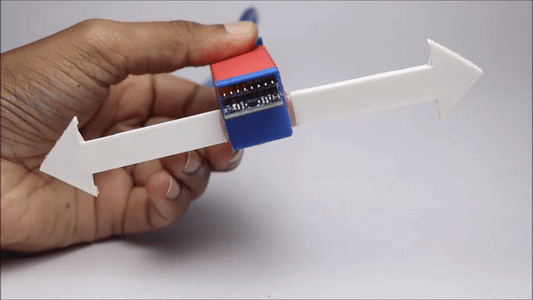

Step 4: Casing Electronics
This is the interesting part for me, I can see that the messy electronics are consolidated inside a small frame.
I have made this in the hard way, The jumper cables that I used were hard and not flexible but anyways i applied some force and was finally able to make that fit inside the 3d printed cases.
If you have difficulty I recommend using shorter length jumpers they occupy less space and are flexible compared to what I used.
Start by gluing the gyro sensor first, here you need to glue it on a 0 degree angle because these are sensitive to movements and the initial leveling should be perfect for making this work properly.
Use a decent amount of hot glue wherever necessary and double check if all the wires are secured because after everything is inside the case it is difficult to open circuit again.
