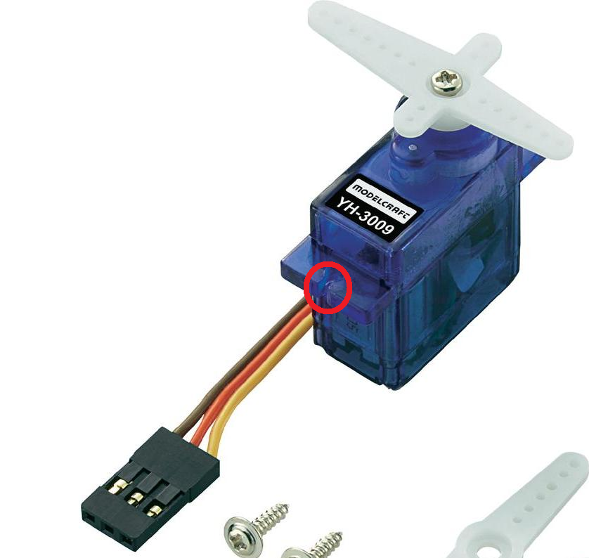

Important note: before you start mounting your servos, make sure your servo wing is properly secured to the servo by using the corresponding screw. There will be no way to access the top of the blade once it's mounted!
Important note #2: Before adding the servos to the frame, make sure to turn them entirely one way either with your hand or by running a script. This will make setting up your code lots easier later on in the process!

Servos are fairly easy to connect, start by taking a look at the cables that come out of it. In almost all cases there should be three wires colored yellow -> red -> brown or brown -> red -> yellow respectively. To connect your servos, make use of the scheme below:
- Yellow wire -This is the cable that you want to connect to either a digital or analog port on your Arduino depending on whether you have an analog servo or a digital servo.
- Red wire - This is the power supplement for the Servo, should always be connected to the 5V output on Arduino.
- Brown wire - This is the ground cable for your servo. Make sure to plug this into the ground (or GND) plug on Arduino.
