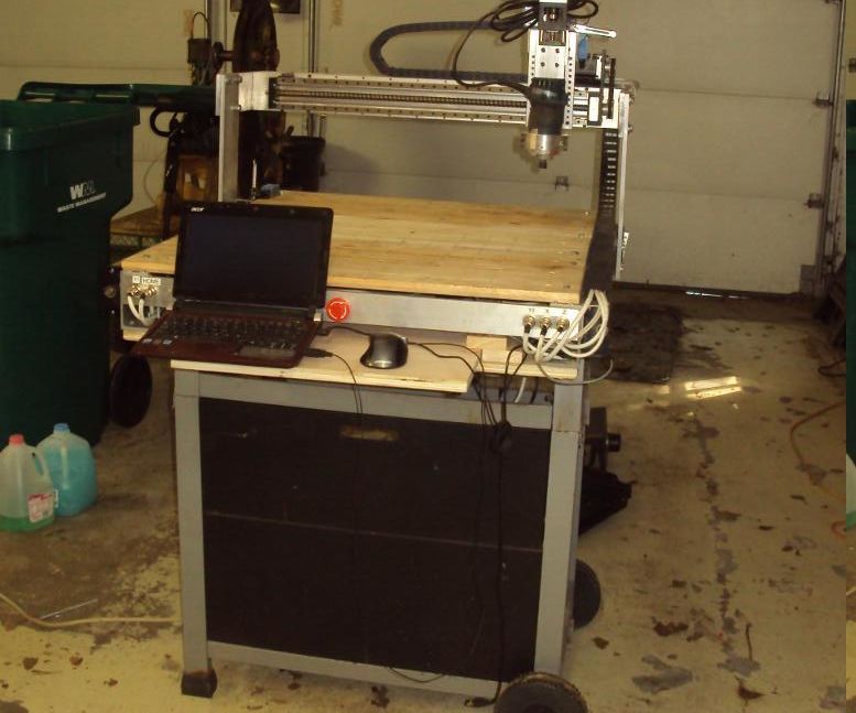

I was back in the machine shop at my workplace and in the scrap bin I found eight ball screw slides. The longest has about a 23" stroke.I asked my boss, and he let me take them.After some investigation, they've been sitting on a shelf for years and they just decided to scrap them.
So I decided to use four of them to make a CNC router.

Anyway, except for the 4" aluminum channel and wood I purchased for the Y-axis slide mounting, I'm built this thing with materials I have laying around and without any plans. It's just kind of fell together as I went. (I'm amazed at the quantity of aluminium barstock I've accumulated. Some of this stuff I didn't even know I had).
The first step was to build the frame rails which were 4" aluminum channels. To these I mounted two of the ball screw slides.
Step 2: Table Top
To make the table top, I used 5/8" thick wood planks often used for shelving. I cut them to the proper width then bolted them to the frame with 1/4-20 bolts.
Therefore if one plank gets damaged, it can be easily replaced.
Step 3: Y-Axis Vertical Rails
I clamped two pieces of 3/8" thick x 4" wide aluminium barstock together. I then drilled out the holes for mounting. In this way I created exact mirror images of the plates.
Then I drilled/tapped the blocks which will mount the X-axis rail.The to see my progress, I C-clamped the X-axis in place. Later transfer punch the mounting holes in the slide to the blocks. Then drill/tap the blocks to mount the rail permanently.

First was to make a plate to adapt the X-Axis carriage to the Z-Axis frame. Note that I added several extra holes in the plate. This allows adjustment of the Z-axis height.
The reason is that unlike many CNC routers I've seen on the Internet, I purposely kept the distance between the table and the X-axis slide shallow, about 7 inches.
The reason is threefold:
  1. The longer the side arms, the more deflection there will be in the final system.
  2. The slide has a 4 or 5 inch stroke, so I really didn't need much.I was somewhat limited by the material I had laying around.
  3. I could have added about 3-4 more inches, but see number 1.
Once the Z-axis was mounted, I started an adaptor plate to mount the Z-axis motor to the slide. The motor is way big for this slide, so I'll turn down the amperage to limit the motor.
Step 6: Router Motor Mount
Based on internet searches, people have been successful using a Bosch Colt router for this application, so I went the same route.
I need to make a collar for to mount the router. I have machine tools, so I make my own, but I know there are ebay sellers who sell mounts for this particular router.
