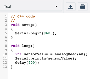

Now that we placed all the components , we program the Arduino to read and display value from the photoresistor on the Serial Monitor. Go to "Code" on the top right of the page and set the option to "Text", which will allow you to program your code into the Arduino.
  1. As shown above, our first command is Serial.begin(9600), which sets the program to run at 9600 bits/second, the standard communication speed for the Arduino.
  2. Set the A0 pin to read photoresistor value as an integer
int SensorValue = analogRead(A0);
Serial.println(SensorValue);
  1. SensorValue = value from the photo resistor
  2. analogRead() = reads the value from the specific pin (values between 0 - 1023)
  3. Serial.println() = prints out the value on to the Serial Monitor when running the program
  4. Lastly, set the time as to how long the program should pause before continuing using the delay() function.
  5. delay() = uses a value to communicate amount of time to pause
  6. 1000 = 1 second
  7. The higher the value, the more time it pauses
  8. The lower the value, the less time it pauses
Now , open the Serial Monitor of the bottom of the Code page , and run it.
  • When there is little / no light detected by the photoresistor, intensity value decreases
  • When there is light detected, intensity value increases

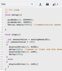

From this point, connect the LED and the 330 ohm resistor onto the circuit as well. Connect the LED starting from row a ; column 25 on the cathode and connect the resistor starting from row c ; column 26. Once we place all the components onto the breadboard, connect the green wire to pin 13.
We are testing only one LED, and so we should connect to pin 13 and set it as an output. For every output, there should be an input, so the A0 pin will be set as the input because it is connected to one leg of the photoresistor. Therefore, the A0 pin will read light intensity value, which will determine when the LEDs powers on and off.
  • use the pinMode() function to set the pins as inputs and outputs
  • set up the standard communication as 9600 bits/second
pinMode(13, OUTPUT);
pinMode(A0, INPUT);
Serial.begin(9600);

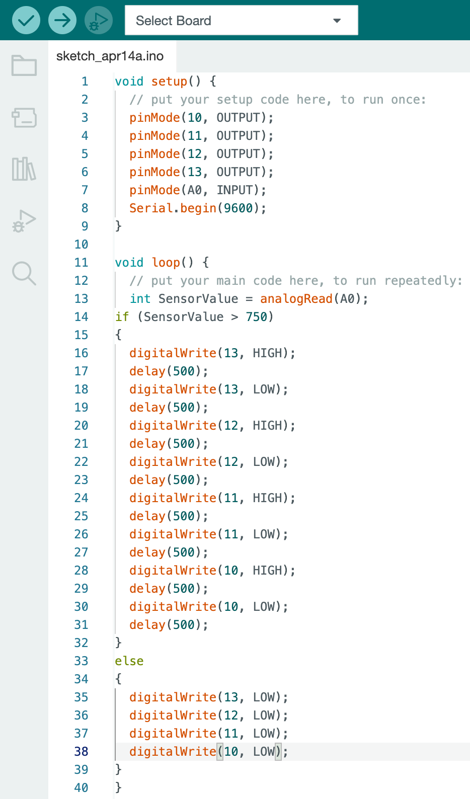

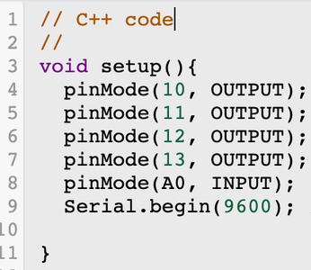

Programming the 3 LEDs
  1. repeat same steps for the 1st LED on to the other 3 LEDs
  2. set the other pins as outputs but A0 pin is the same input
  3. set up the standard communication speed of 9600 bits/second
pinMode(10, OUTPUT);
pinMode(11, OUTPUT);
pinMode(12, OUTPUT);
pinMode(A0, INPUT);
Serial.begin(9600);

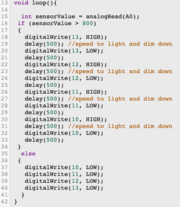

  1. repeat the same procedures, use the digitalWrite(pin, value) LED bulbs
  2. set the amount of time the program must wait before continuing with delay() functions between each pin
digitalWrite (13, HIGH);
delay(500);
digitalWrite (13, LOW);
delay(500);
digitalWrite (12, HIGH);
delay(500);
digitalWrite (12, LOW);
delay(500);
digitalWrite (11, HIGH);
delay(500);
digitalWrite (11, LOW);
delay(500);
digitalWrite (10, LOW);
delay(500);
delay(500);
  1. Run the program, see what happens to all the bulbs when you test the circuit LEDs. They should light up in a pattern.

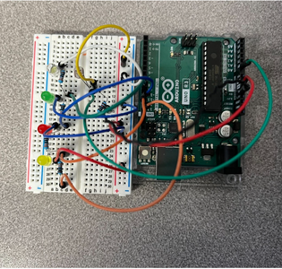

Step 5: Building Physical Circuit
Now, it's time to assemble our physical circuit! Using our Circuit Model from TinkerCAD, we have to build the physical model of the circuit to test in real-time! When connecting the LEDS, there are 2 legs of the bulb which Anode and Cathode. The way to tell them apart is that the anode is longer than the cathode in the physical bulb. So, do not mix them up.
Programming the physical circuit :
  1. Plug in one end of the cord into the USB connector and the other end into the computer.
  2. Download Arduino IDE and open up a page to start your code.
  3. Enter in your program from TinkerCAD into Arduino IDE for the 4 LEDs, verify to ensure it's error-free before uploading. If no errors are detected, upload, and test the circuit by switching your room lights on and off.
  4. When the lights are out, you should see it in blink in a pattern from the last LED to the first LED.
What happens if it does not upload?
Do make sure you enter the correct port. At first, I noticed only one bulb blinked when plugged in and found out that it just means the Arduino is not fully set up. In order to set up the Arduino, click on "Tools" , then when you click on "Ports", choose the Port that says "(Arduino Uno)".

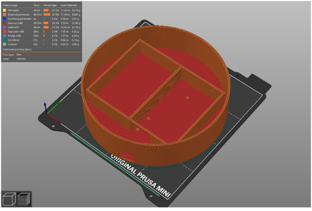

Step 7: 3D Printing Base

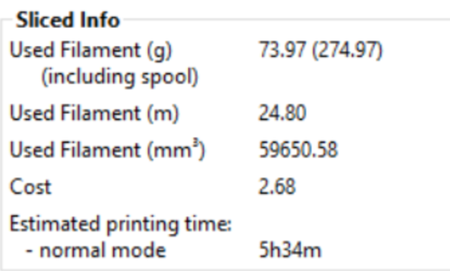

Before we officially 3D print our whole design, we must 3D print some test models to ensure we get the measurements correct! So, if you have access to a PrusaSlicer Mini+, do download the Prusa Software to help with the 3D printing process. I did this step in parts, with test printing only the Arduino compartment first, then printing the full base. Before I started 3D printing, I imported the design from Fusion into Prusa as a .3mf file.
For the first part, test print just the Arduino compartment to ensure it fits well and screw holes were plotted correctly . When you open your project on Prusa, you can simply use the "trim" option on the left panel to cut off parts of the design for the test prints. For this instance, I use the "trim" option to cut off the rest of the base so that I could just print the Arduino compartment. Once I was done trimming, I clicked on "Slice Now" which shows the print settings and amount of time to print.

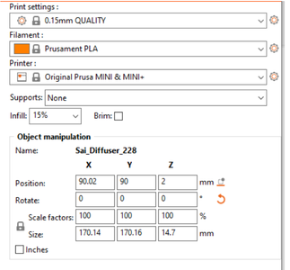

  1. On the right there are settings for the print, such as Infill, Brim, and Supports. For the test prints, set your Prusa to 10% infill with no supports and set temperature to 230 degrees Celsius.
  2. Once everything is done, click on "Export G-code" and download your file into an SD card for the printer
  3. Plug in the SD card, and make sure to add a thin layer of Elmer's glue stick on the build plate to prevent the print from sticking permanently during the 3D printing process. For this project, I added Purple Gold color Prusa PLA Filament into the machine for the final model, but you can choose whichever color you like, because for my test prints, I used different PLA filament colors.
  4. Adjust the print settings on the 3D print machine to ensure all settings are set correctly, and then create the test print.

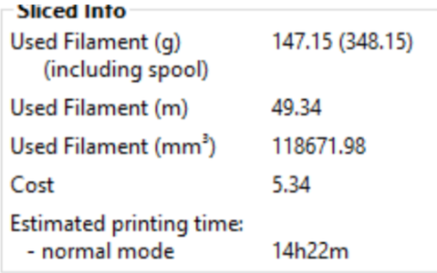

Final Model
  1. Repeat the same steps from importing the base into Prusa, but this time, leave the base as it is with no changes.
  2. If the test prints worked , this serves as your final print.
  3. For the final model, increase the infill to 15% with no supports.
You have your physical base.

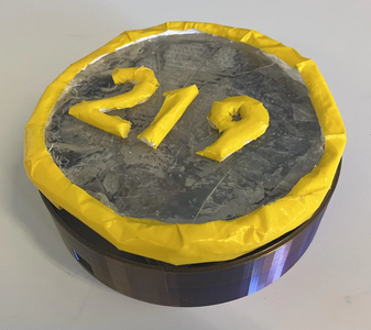

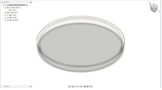

Step 8: Designing Diffuser
The idea of the design is to have a lid that easily is placed on top of the base. Just like for the base, I opened Fusion and started a new design for the diffuser. For this step, I had to create a total of 3 circles. One on the bottom face and the other 2 on the top face of the design.
  1. For the diffuser, we are creating a circular shape diffuser, since the base is cylindrical , so I created a sketch on the xy-plane , and on that sketch, I created a 6.6 in circle from the center . Finish the sketch and extrude the circle downwards by 0.1 in. Since this is a diffuser, the material should be transparent so that light can pass through when the nightlight operates. Change the physical material to "Plastic Transparent".
  2. On the bottom face, create a sketch of a 6.5 in wide circle, then a 6.4 in wide circle on top, finish the sketch and extrude
  3. After the extrusion, make into a new body and change the physical material
  4. For my model, I changed the material to "Porcelain".
  5. Within that 0.1 in space between the circles, extrude down by 1 in
  6. Rotate the design back to the top view and create a sketch of any design you like . For my model, I typed in my number 219 in the center using the "Text" feature under the "Create" tab.

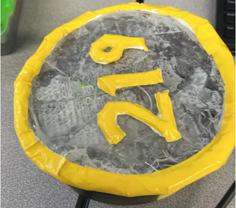

Physical Model:
  1. I used epoxy resin to make the diffuser instead. It comes in two parts, A and B
  2. Part A = resin
  3. Part B = hardener
  4. I added both parts in a 1:1 ratio , mix slowly together before adding into the mold
  5. Be very precise in measuring ! If a measurement is slightly off, it may affect the outcome of your diffuser.
  6. Once mixed, pour in the plate mold and let it cure overnight next to a heater because it speeds up cure time .
  7. The next morning, I picked it off the mold and tried cleaning all the residue from the mold.
If you want to make a physical design...
  1. For my example, I used air dry clay and molded into the numbers "219"
  2. When it was molded, I placed it on the cured resin and let it set overnight by the heater.
  3. For my project , I painted with white and covered with duct tape . However, it's completely optional to do it for your own.
Step 9: Final Models + Conclusion
Now you have your models ready ! Once you added your circuit in to their respective compartments, slowly place your diffuser on top!
  1. Slowly try to push the circuits inside their compartments .
  2. Do not try to force them to fit in the compartments as you may risk breaking it in the process.
  3. Secure the wires to make sure they are connected when testing the circuit in the final product .
Plug in your model through the outlet space and into your computer, run the program, and you have your own night light!
It took me around 5 months to assemble the entire project and program the circuits for the project. Along the way, I got experience in 3D modelling and design with Fusion as well as programming a circuit for the first time. There was definitely obstacles along the way when it came to different steps from measuring dimensions to printing perfect models of my base. I really want to say a big thanks to Ms. Berbawy for helping me throughout the course of the project.
