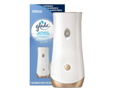

  1. Automatic, electric air freshener

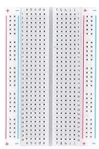

  3. Two wiring breadboards with pin inputs

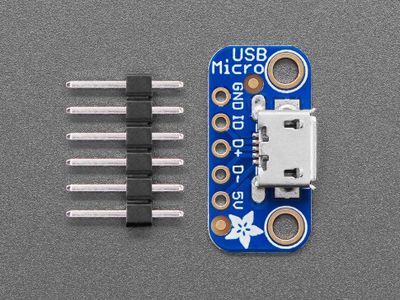

  5. Micro USB breakout board

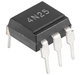

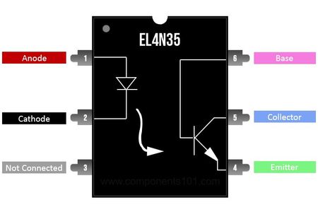

  6. 4N35 Optocoupler

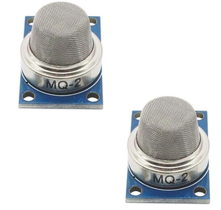

  7. MQ2 Gas Sensor

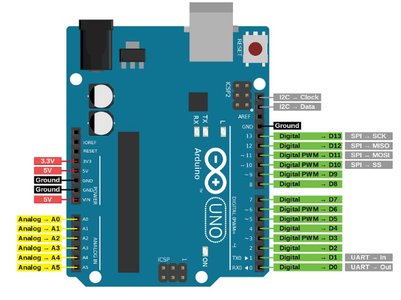

  8. Arduino UNO Programable Board

  1. Connect the analog pin on the MQ2 gas sensor to the analog input (A0) on the Arduino UNO (Green Wire)
  2. Connect the GND pin on the MQ2 gas sensor to the GND rail (Black -) on the breadboard (Black Wire)
  3. Use an external power supply (5V-2A) to simulate our USB-C breakout board. Connect the positive terminal (red) the power rail (red +) on the breadboard (Red Wire)
  4. Connect all voltage pins on the MQ2 Sensor to the power rail (red +) to supply power to our sensor (Red Wires)
  5. Add an FN35 optocoupler to the breadboard. Connect the GND pin to the GND rail (Black -) (Black Wire).

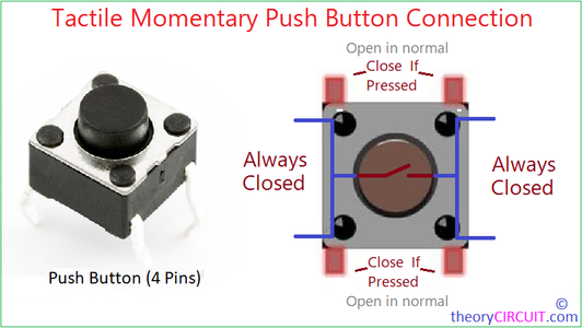

  6. On the FN35 optocoupler, connect the collector pin to the button switch pin (Pink Wire) and connect the emitter pin to the second pin on the button switch (Black Wire). This way, the light from the LED inside the optocoupler activates a phototransistor, causing it to complete the circuit between the button switch, simulating pressing the physical button.
  7. Wire the Digital Pin on the optocoupler to the digital input on the Arduino Uno (D2) (Blue Wire)
  8. Add a 470 Ohm resistor between the resistor and the digital pin. The Arduino digital pin outputs a voltage of 5 Volts, which will damage the optocoupler. We need to add this resistor to lower the current and voltage going into the device within allowable levels. *Calculations attached as a photo*

  2. Wire the MQ2 sensor according to our design schematic. The one we purchased has four pins, not six like our schematic. It includes a voltage pin (5V), ground pin (GND), analog pin (A0), and digital pin (D0). Wire the 5V pin to the positive (red +) rail on our breadboard, the GND pin to the negative (black -) ground rail on our breadboard, and the analog pin (A0) to the analog pin on our Arduino UNO (A2). We will not use the digital pin (D0). *NOTE: we are powering the MQ2 sensor with a Micro USB powered breakout board - this is safer for all devices than powering it with the 5V pin on the Arduino UNO*
  3. On a separate breadboard, place the Micro USB powered breakout board. Wire the voltage pin (5V) to the positive rail (red +) on the MQ2 sensor breadboard. Wire the GND pin (GND) to the second GND pin on the Arduino UNO.
  4. Place the optocoupler so that 3 pins are on each side of the breadboard. Wire the collector pin (pin 4) to one side of the button switch. Wire the emitter pin (pin 5) of the optocoupler to the opposite pin [same side] of the button switch. Add our 470 ohm resistor to the anode pin (pin 5) of the optocoupler. Wire the end of the resistor to the digital pin (D2) on the Arduino UNO. Wire the optocoupler GND pin to the negative rail (black -) on the breadboard. Connect the Arduino GND pin to the negative rail (black -) on the breadboard. *NOTE: We are powering the optocoupler with the digital pin (D2) on the Arduino UNO. It is NOT connected to the breadboard power rail. The digital pin sends a signal of 5V to the optocoupler, which we reduced to a safe voltage using our resistor*

Connecting the wires from the Collector pin and Emitter pin on the optocoupler to the air freshener button switch pins will require soldering. Use a soldering iron to connect the pin wires as shown.

  5. Test that the switch activates the air freshener when gas levels exceed your defined threshold. You can adjust the threshold as necessary. *NOTE: The air freshener must be powered on for the switch to trigger the release a spray of air freshener*
