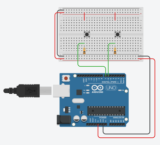

Step 5: Push Buttons
Functionally, a push-button simply connects a wire which sends 5V to an input pin on the Arduino, which can be read as a signal to do something.
I used a pull-down resistor for each button. By putting a resistor before ground, it ensures that when the button is not pressed (open), the input pin on the Arduino will read 0V, but when it is pressed, the input pin will read 5V. To say it another way, when the button is open, the input pin is connected to ground through the resistor as "LOW". When you press the button, it closes the wire and creates an "easier" (no resistance) path to 5V, changing the input pin to read "HIGH".
More info on using pull-up and pull-down resistors with Arduino input pins.
Note: In doing some additional reading afterwards, it appears Arduino may have built-in pull-up resistors that can be accessed from software, so I likely did it the hard way. Also, a push-button can be implemented using either a pull-up or a pull-down resistor configuration, each which has pros/cons that i'm not sure I fully appreciate, but using a pull-down setup worked in our project.

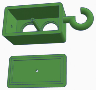

Step 6: 3D Printed Enclosures
My son has some skills with Fusion 360, so he whipped up a model for the enclosure and the button "remote" box. The button openings are 30mm to accommodate the Sanwa arcade buttons and allow them to clip-in. We printed a few tests to ensure the opening in the main enclosure was just the right size to fit the stacked LED displays. We hot-glued everything onto the case. Hot-glue is great for sticking things together, but can still be removed (with some effort) if you need to fix/change something.
Pro top: be aware the hot end of the glue gun can easily melt your PLA model in certain spots if you're not careful where you wave it around.
