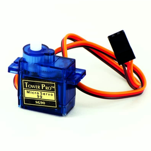

  3. Servo motor

Servo Motor:
  1. Connect the Yellow Pin to the Digital Pin 7.
  2. Connect Black to Arduino's GND.
  3. Connect Red to Arduino's 5V.

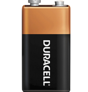

Power Supply:
  • Connect Battery: Positive terminal to Arduino's 5V.
  • Negative terminal to Arduino's GND.
