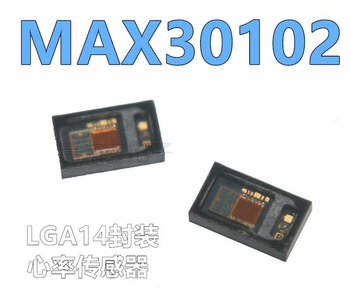

Advantages and Features of MAX30102:
  1. Heart rate monitor and pulse oximeter sensor input LED reflection solution

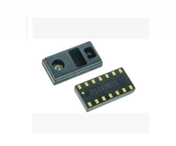

  2. Miniature 5.6mm x 3.3mm x 1.55mm 14-pin optical module
  3. Integrated cover glass for optimal and robust performance
  4. Ultra-low power operation for mobile devices
  5. Programmable sampling rate and LED current saving
  6. Low-power heart rate monitor (<1mW)
  7. Ultra-low standby current (0.7μA, typical)
  8. Fast data output capabilities
  9. High sampling rate
  10. Powerful motion artifact recovery capability
  11. High signal-to-noise ratio
  12. Operating temperature range of -40°C to +85°C
Step 3:

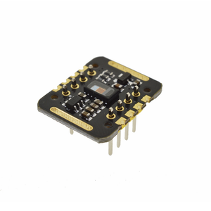

MAX30102 Wrist Heart Rate Module
It consists of two light-emitting diodes, one photodetector, optimized optics, and low-noise analog signal processing to detect pulse oxygen saturation and heart rate signals.

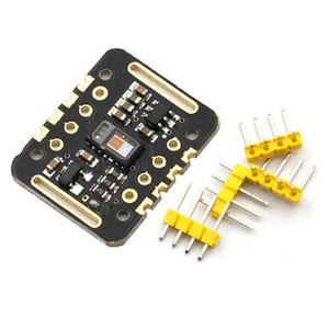

MH-ET LIVE
MAX30102 Heart Rate and Blood Oxygen Sensor Module
Main Parameters:
  1. LED Peak Wavelength: 660nm/880nm
  2. LED Supply Voltage: 3.3~5V
  3. Detection Signal Type: Photoplethysmographic (PPG) signal
  4. Output Signal Interface: I2C interface
  5. Communication Interface Voltage: 1.8~3.3V to 5V (selectable)
  6. Reserved Mounting Hole Size on Board: 0.5x8.5mm

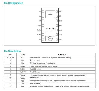

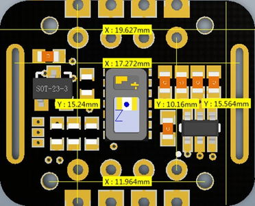

  7. Pin Description:
  8. VIN: Main power supply input, 1.8V-5V.
  9. 3-Pad Selector: Used to select the pull-up level for the bus, depending on the voltage of the main control pin. You can choose either the 1.8V pad or the 3.3V pad (which includes 3.3V and above).
  10. SCL: Clock line for the I2C bus.
  11. SDA: Data line for the I2C bus.
  12. INT: Interrupt pin for the MAX30102 chip.
  13. RD: Ground for the RED LED on the MAX30102 chip; typically left unconnected.
  14. IRD: Ground for the IR LED on the MAX30102 chip; typically left unconnected.
  15. GND: Ground line.

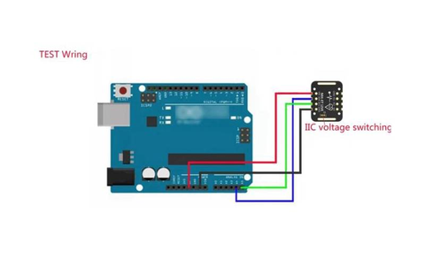

Schematic diagram of the MAX30102 wrist heart rate module experimental wiring.

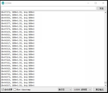

Initializing…
Place your index finger on the sensor with steady pressure.
