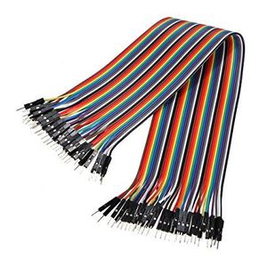

  2. Male to male Arduino Jumper Wires

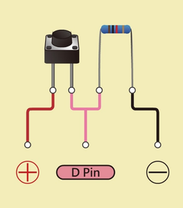

Step 2: Connecting the Circuit
  1. connect D2pin 4 to gnd
  2. Connect one of the two legs of the button to 5v and another leg to D-pin 2 and a resistor.
  3. Connect the resister to gnd.
  4. then the circuit is finished!
