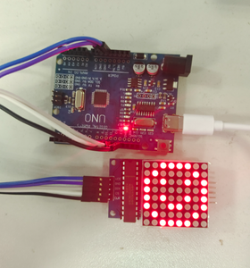

Step 5: Wiring With Arduino UNO R3 Development Board
MAX7219 LED Matrix Module to Arduino UNO Connection
  1. VCC: Connect to 5V on the Arduino.
  2. GND: Connect to GND on the Arduino.
  3. DIN: Connect to digital pin D11 on the Arduino.
  4. CS: Connect to digital pin D10 on the Arduino.
  5. CLK: Connect to digital pin D13 on the Arduino.
Step 6: Dot Matrix Display Experiment
Matrix Display for Specific Patterns
  1. This experiment utilizes an Arduino UNO R3 development board and a custom-built circuit to achieve the desired functionality.
  2. The circuit diagram for the matrix display of specific patterns is shown below:
  3. Experiment Preparation: Install the "LedControl" library.
  4. Functionality: The matrix will display arrows (up, down, left, right), three different facial expressions, and three types of hearts.
