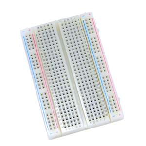

  2. Breadboard

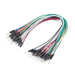

  5. Jumper wires

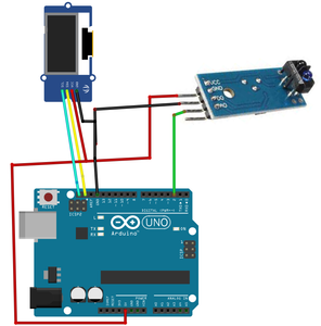

Step 2: The Circuit
  1. Connect Obstacle avoidance sensor pin[VCC] to Arduino pin[5V]
  2. Connect Obstacle avoidance sensor pin[GND] to Arduino pin[GND]
  3. Connect Obstacle avoidance sensor pin[D0] to Arduino digital pin[2]
  4. Connect OLED Display pin [SCL] to Arduino pin [SCL]
  5. Connect OLED Display pin [SDA] to Arduino pin [SDA]
  6. Connect OLED Display pin [VCC] to Arduino pin [5v]
  7. Connect OLED Display pin [GND] to Arduino pin [GND]

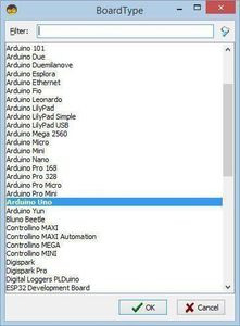

Step 3: Start Visuino, and Select the Arduino Board Type
Start Visuino as shown in the first picture Click on the "Tools" button on the Arduino component (Picture 1) in Visuino When the dialog appears, select "Arduino UNO" as shown on Picture 2

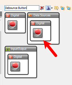

  1. Add "Debounce Button" component

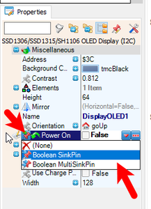

  3. Select "DisplayOLED1" and in the properties window select "Power On" and click on the pin icon and select "Boolean SinkPin"

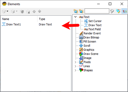

  4. Double click on "DisplayOLED1" and in the Elements window drag "Draw Text" to the left side and in the properties window set "Size" to 3 and "Text" to ARDUINO or any other text

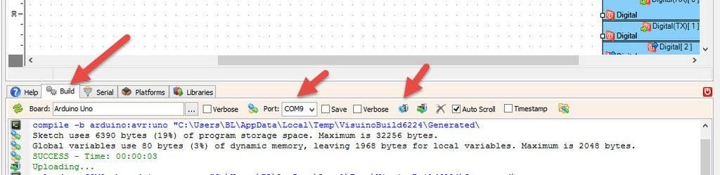

Step 6: Generate, Compile, and Upload the Arduino Code
In Visuino, at the bottom click on the "Build" Tab, make sure the correct port is selected, then click on the "Compile/Build and Upload" button.
