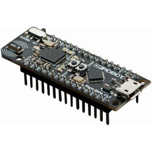

1 Bluno Nano (Any Arduino micro-controller with enough pins and 5v logic can be used) [$33.55]

MAX30100 VCC to Bluno +5V
MAX30100 GND to Bluno GND
MAX30100 SCL to Bluno A5
MAX30100 SDL to Bluno A4
