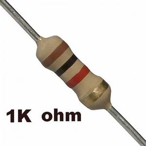

  • A pushbutton
  • An LED
  • 220 - 1K ohm resistor
  • An Arduino UNO (or any other Arduino)
  • Some wires

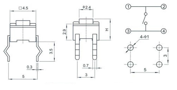

Step 1: How It Works
A pushbutton is basically two contacts that are shorted together when pressed upon. The two contacts conduct current, which allows them to complete a circuit. In most circuits, the 10K resistor for the pushbutton is unnecessary, and only used if the pushbutton has very long leads or wires connected to it. The 10K resistor just prevents the voltages from floating, and keeps them grounded.
In our case, we just need 2 wires for the pushbutton to operate.

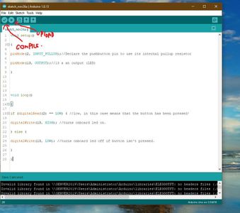

Step 3: The Code
If you have ever used a pushbutton before, with a resistor, you may know that in the code, you read the value of the pushbutton's pin, and see if it has gone HIGH. This would mean that the pushbutton has been pressed. If it is LOW, it would mean that the button is not pressed.
This all makes sense, but in our new example, things are opposite.
Here is the code:
void setup()
pinMode(2, INPUT_PULLUP);//Declare the pushbutton pin to use its internal pullup resistor
pinMode(13, OUTPUT);//13 a an output (LED)
void loop()
if (digitalRead(2) == LOW) { //low, in this case means that the button has been pressed!
digitalWrite(13, HIGH); //turns onboard led on.
} else {
digitalWrite(13, LOW); //turns onboard led off if button isn't pressed.
Copy and paste it into the Arduino IDE, as shown above, and press select your board and port in the 'Tools' tab. (Images for reference) and then press the upload button (Images for reference)
