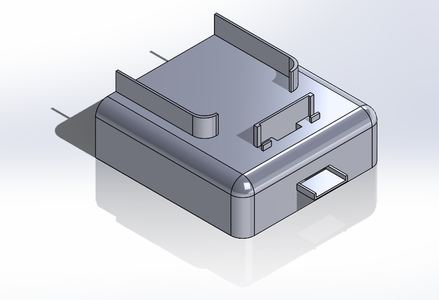

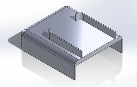

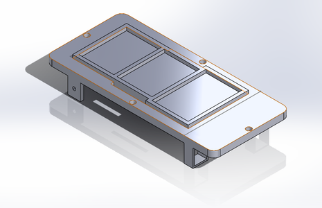

Step 2: Creating SOLIDWORKS Parts
After planning, we had an idea of what we wanted to construct and got to work on SOLIDWORKS. We designed a base plate that has 3 sections on the top which hold the Arduino Uno Circuit, Arduino Breadboard, and the battery pack. On the bottom, two sections hold the gear motors in place which is where the wheels will be placed.
We also created the top portion that would consist of the curved walls that hold the phone in place, the hole that allows for the IR sensor to be visible, a platform for the 3 line sensors to be able to point at the ground, a platform for the Ultrasonic Distance Sensor to sit and face the front. Keeping in mind the size of the 3D printer, we split the top plate in half before submitting the parts to be printed.
