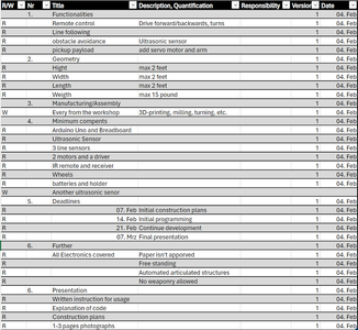

Step 1: Requirements and Technical Decisions
Project requirements were defined prior to the technical decisions in order to develop a car that satisfies the requirements and works efficiently.

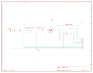

Tinkercad was used to create circuit diagram and electrical drawings. They were later used to assemble the car.

Once the power supply assembly and the control assembly are complete, the control assembly can be mounted on the power supply assembly and then top cover placed on the control assembly to fabricate the final car. With the lid removed, wire the electronics according to the wiring diagram provided. Then, upload the code and have fun!
