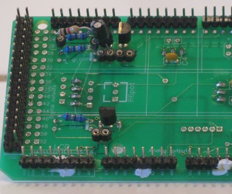

Step 6: Arduino RC Circuit
The Arduino board produces a PWM signal from digital pin 10. The PWM signal passes through R1 and the capacitor (the RC components). The output from the RC filter passes through the second resistor (used to limit current to LED). The current flows through the LED to ground.
The signals before and after the RC filter can be seen by placing oscilloscope probes at the points indicated in the diagram.
This picture was made using Fritzing.
Example code to control the Arduino board and vary the PWM can be found on the Arduino website: http://arduino.cc/en/tutorial/fading. Change the digital input from pin 9 to pin 10.
