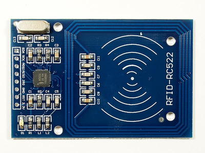

MFRC522 RFID module

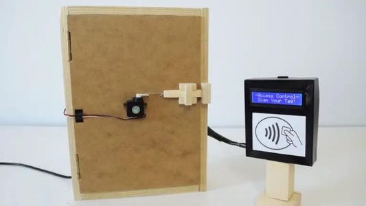

Step 1: Work Process
First we have to set up a master tag, then the system goes into normal mode. If we scan an unknown tag, access will be denied, but if we scan the master, we will go into program mode from where we can add and authorize unknown tags. So now if we scan the tag again, access will be granted so we can open the door. After we close the door, it will automatically lock. If we want to remove a tag from the system, we just need to go into program mode again, scan the know tag, and it will be removed.

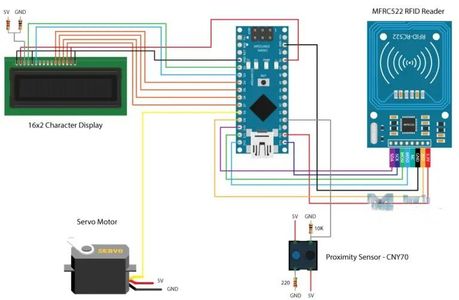

Step 2: Circuit Schematic
