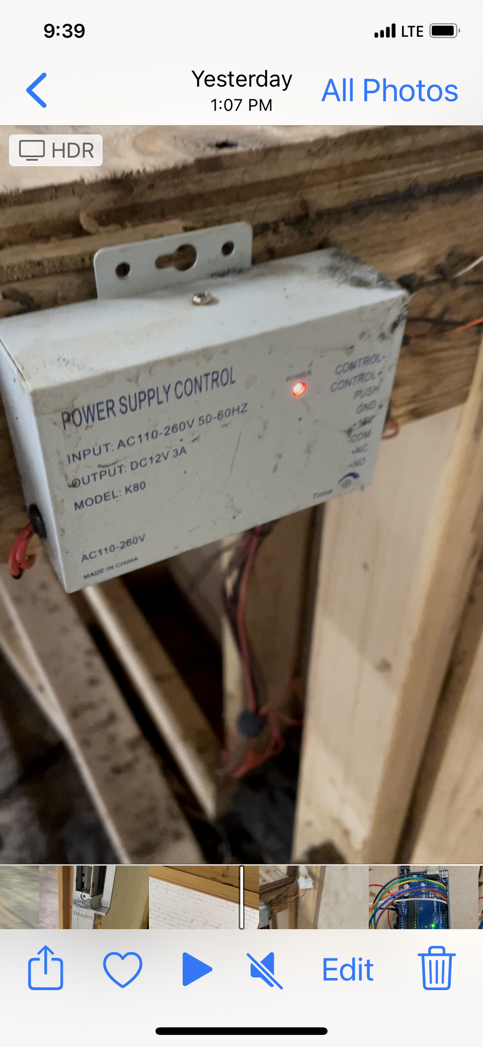

Step 3: Wire Up Electric Door Strike to Power Converter
Follow instructions that came with the power converter and door strike. On the converter you need to have the control connection running to pin 8 on the Arduino. This is the pin that gets set HIGH when the correct card is read on the rfid reader.
