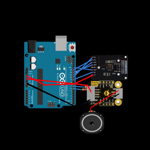

This is the RFID wiring diagram.

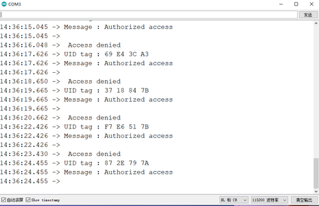

Locate the encoding for each tag via the Arduino serial port. Specifically, open the Arduino example files, navigate to the RFID folder, open the cardread file, and upload it. Then scan the RFID tag with the RFID reader and check the encoding for each tag in the serial port.
View the tag encoding after scanning the tag in the serial port
Step 3: Wiring Diagram
