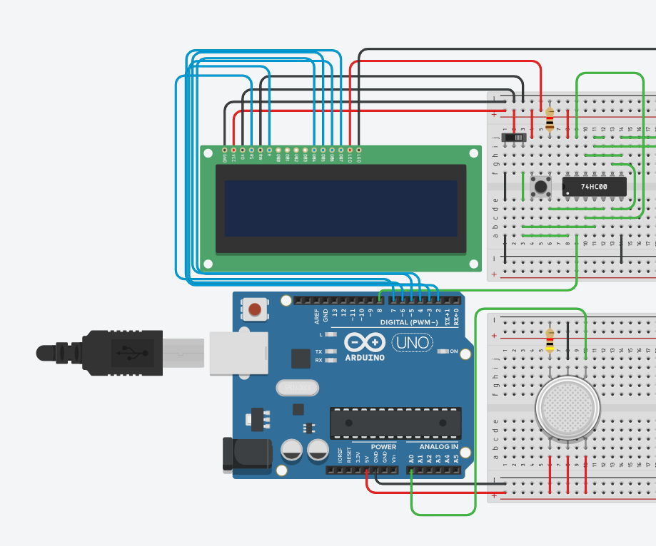

Set-up RFID sensor(construction of the box is not needed currently)
I will leave a link to another article of where I had learned to set-up the RFID sensor. This is important as you will need to do this in order for it to work. This is because every keycard/keytag has its own unique code to it. So you can't simply copy someone's code and be like "I'm all set to go". This part is the most crucial. The wiring layout is also shown in the article. But just in case, I will leave it here.
